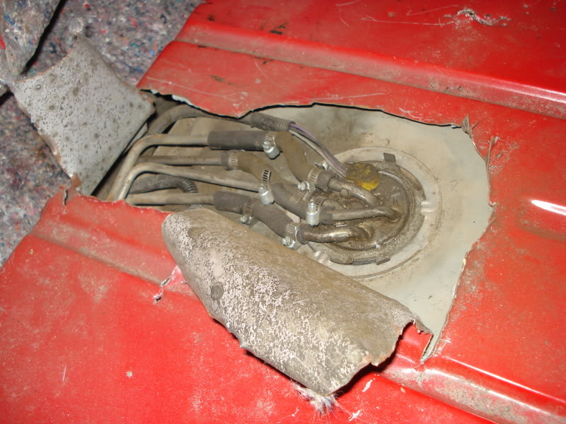

Speaking of the devil, I decided to pull my carpet up and look what the PO did!
Wonderful.

Originally Posted by servo2055chevy
Why do I HAVE to cut the tubes? Isn't there rubber lines on there already, because i thought it was like a few inches of steel tubing from the unit then it went to rubber lines that came down from the tank for flexing and whatever :S
Yea you gotta cut em or make a big mess cutting the hole.
Rubber hose rated for FI will patch it back just fine.
[AZ has the good Goodyear FI rated hose by the ft]
Use stainless steel covered hose if you want to make it perdy.
If you have any problem with say a bend where the hose wants to kink, put hose clamps in the cents n fore n aft of it and use them to make it stay round/bend how you want.
THESE ARE NOT MY PICS

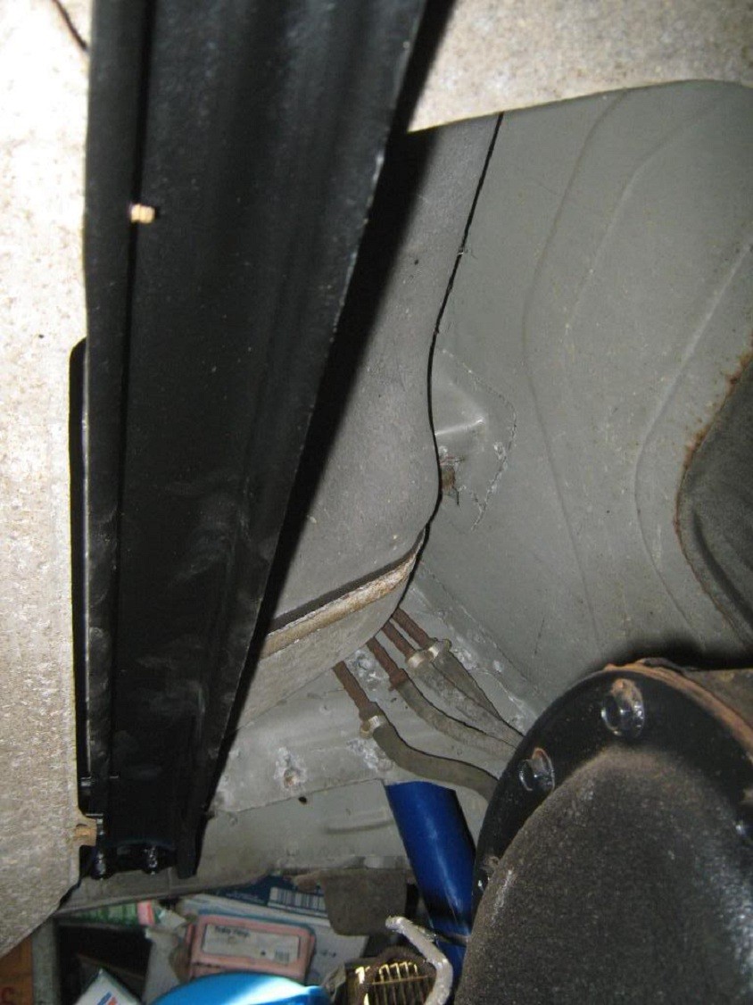

The hard lines run forward as you've seen in the pics, turn 90 degrees toward the drivers side, drop down to the bottom of the tank & THEN connect to rubber lines.
In the pic I attached, you can see that the hard lines are basically between the tank & body, until they get near the rear end. So the hard lines have to be cut, if your not gonna drop the tank, to get the pump/pick-up assembly out.

Ok guys, I cut the panel. little rusty on the lines but its expected. I vaccumed the dust and metal shavings and gave it a good spray of wd 40 along the lines and around the metal snap ring. HOW THE HELL DID YOU GUYS CUT THE LINES? THERES NOT MUCH ROOM FOR A BRAKE LINE CUTTER I IMAGINE?? Please help

it is possible. it just takes a little work. the key is to get a mini tube cutter, the lines will give just enough to cut them. just takes a little time, and patience. dont rush it.

I just use tin snips n then fixed the crushed ends, as once cut you can lift n work on em. But I was lazy, take your time if you not good at reshaping the crushed end.

GOOD NEWS GUYS! I got it fixed. I said **** it and used a hack saw to cut the lines. I used wd40 as a lubricant. and i matched the lines with 180PSI hoses that napa gave me. one problem though... the stock black fuel sock that goes on the end of the pump. it was filled with sand now does that sock filter sand or should i be draining my tank right now?

Look down the into the hole of the gas tank for junk.
I tossed a magnet in mine near the sock location when it was open.
but sounds like you need a new sock anyways
Old Feb 18, 2011 | 08:51 AM
Stephen's Avatar
iTrader: (12)
Posts: 12,212
Likes: 13
Car: 87 GTA
Engine: L98
Re: FUEL PUMP ACCESS PANEL
Sounds like your in for dropping the take & rinsing out the sediment in the bottom.
Look at the upside.....Next time it will be easier to get to the pump.
I've always said that doing this mod requires dropping the tank one last time.
