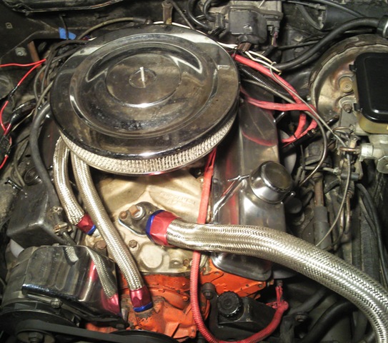

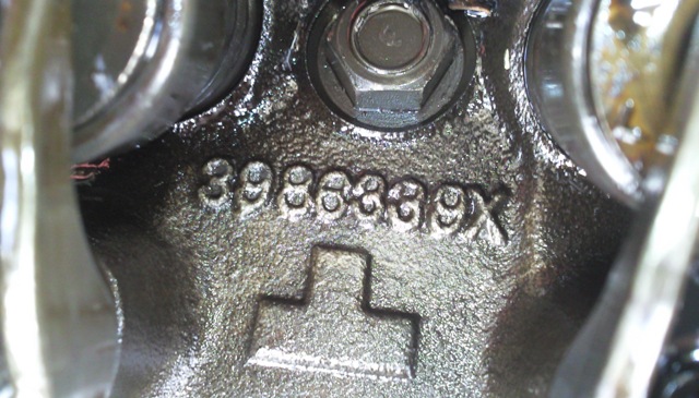

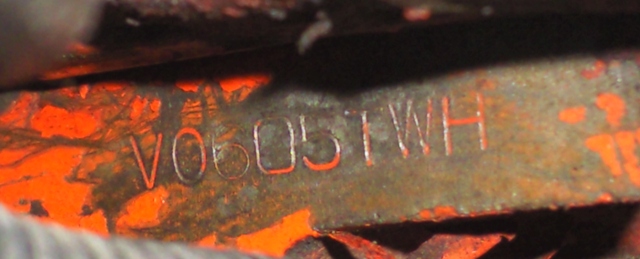

i bought this 83 camaro berlinetta about amonth ago, i was told it had a swap engine on it from a vette, right away tough it was b.s but the engine sounded pretty good so w,e atm i was to exited for the new car. well i bring it home and try to find the engine info but i keep getting stuck. can some one help me decode this. the block # reads 3970010 with GM 35 next to it, the block is orange color, date i belive is this numbers "E165" mayb being May 16 1975 not sure, engine id is v0605TWH. tryed searchig for the TWH suffix for a 3970010 block and it wasnt in any records so i dont know what the heck is going on and YES i AM reading it right. The heads read 3986339X WIth an X, its a 3 speed manual trans, and the engine has a 4bbls carb. Please help, i been on a info hunt for over 2 weeks now Straight, i could sure use a hand from some one who knows.
again block: 397001
Date: E165
engin id/vin :v0605twh
Heads casting#: 3986339x
again block: 397001
Date: E165

Everyone says "corvette" - it's like the end all be all sales pitch. Not sure why exactly, vettes were never known to win many drag races - should use Nova as a sales pitch
3970010 is the same 350 block that most everyone has - it was made from '69 until '79. Might have been from a vette I guess, could have also been from a truck, car, boat, and who knows what else.

And you'll see the heads here - 74cc 307 or 350 heads:
http://www.ecbrcnj.com/id14.html
So - sorry - you have nothing special - standard 1970's 350 block and standard 1970's low compression smog heads.
But - like the rest of us, any 350 is a good 350, power is made in the heads and there are many head options - you have something to build upon as time/money allows!

010 block. Generic 4" bore block. Was used for many years in many vehicles. Was used to make 302, 327 and mostly 350 engines.
Suffix code V0605TWH
Before even looking it up, I can tell you the block came from a pickup truck or van.
V = Flint engine plant
0605 - June 5
TWH = The T means it was in a truck but the WH can't be found in the listings.
It looks like an early to mid 70's 350 truck engine. Not that it really matters. It's still just an 010 block and unless you use it as an original engine, it won't really matter what it came from. Change the cam because the truck cam is made for low rpm work, change the heads (smog heads), change the intake/carb and the suffix code means nothing.
Get the block zero decked and the suffix code will be machined off.
