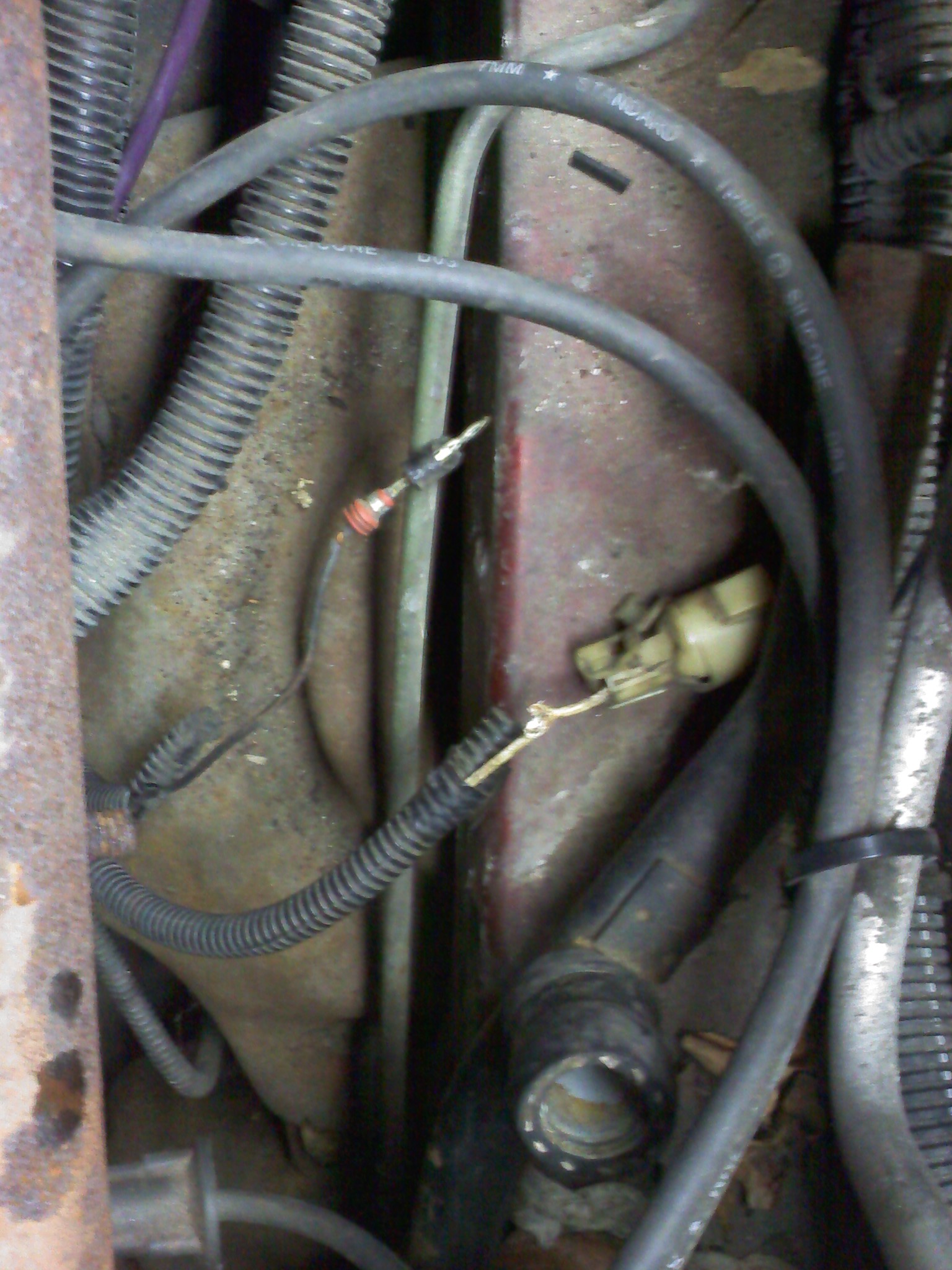

Hi I just bought a 89 trans am GTA 5.7 v8 and i need some help fixing it up. It has a couple of problems that I cant figure out along with some wires that aren't connected to anything. The problem is that after the car is started it will often bog out and then it wont start for like 15mins to an 1 hour but after that it starts back up fine.I also noticed that sometimes gas leaks out near the tank (I don't think the tank has a hole in it). My friend says replacing the fuel pump will solve both problems so I'm looking for opinions. Also the temp gauge doesn't seem to be doing anything even after the car has been running for awhile.
The wiring issue I have is that two different wires coming up from under the engine are not connected to anything (one is almost broken off and the other has no plastic connector). First picture shows these wires. Picture two is a chewed up looking wire under the the upper throttle-body piece. I'm not sure if its affecting anything.

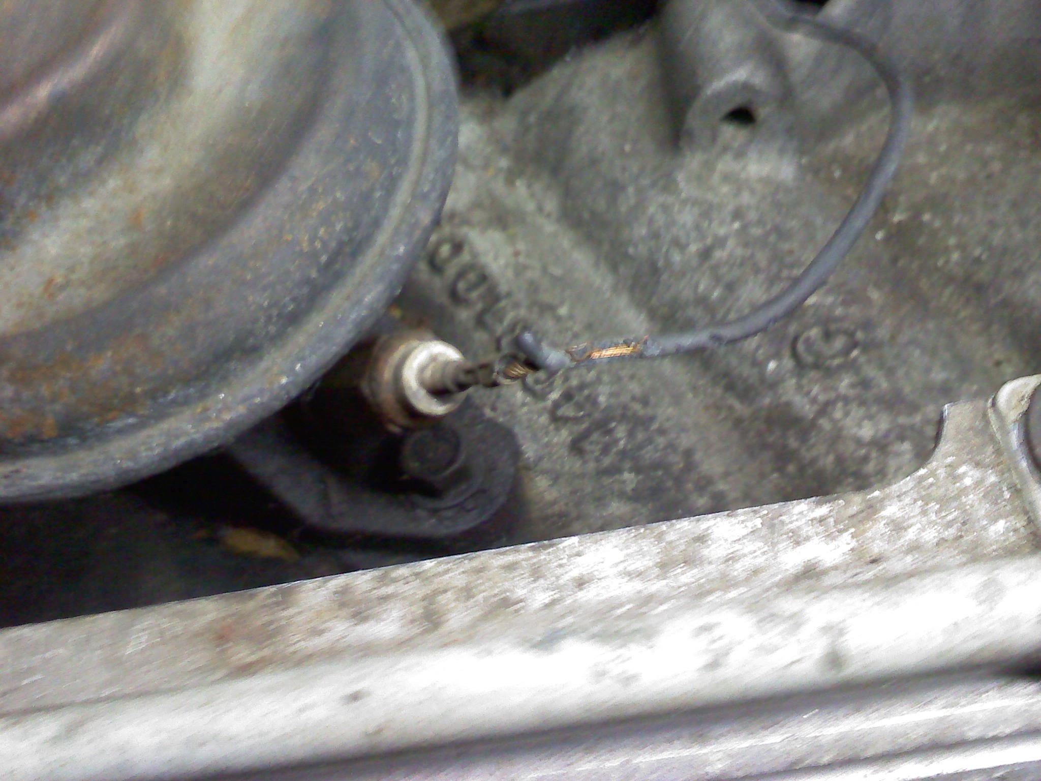

Also the check engine light is on and I plan to scan the error codes but Ide like to figure out whats up with the wire in pic 2 so I can reassemble the throttle-body first. If someone knows how i can solve any of these problems I would greatly appreciate it.

I think I can help with the first picture. There are 2 singe-wire connectors coming out of the same loom. One black (connector butchered) and one white (connector looks OK).
Those would be your knock sensor (single black wire with the butchered connector) and your secondary fan temp switch (single white wire), if memory serves.
You can see where they are supposed to plug in from underneat the car. Knock sensor will be along the pass. side oil pan rail just above and in front of the starter. The secondary fan temp switch will be screwed into the pass. side cylinder head between the rear two spark plugs. The connectors on those two wires should be the same, except for the difference in color. The color of the wire and connector will match the color of the plastic nipple on the sensor they are supposed to plug into (you can plug them into the wrong sensor but the color coding will guide you which one should be where).
I JUST RECENTLY had to figure those exact same two wires out on an 87 GTA, which is why this is fresh in my memory. You can look up my thread in the cooling system section of the board from about a month ago, if you want.
The second picture looks like the EGR temp sensor to me (which gives feedback to the ECM about whether the EGR valve is actually opening and flowing hot exhaust gasses when commanded by the ECM).

I'm still trying to figure out if that wire in picture 2 is important and if I should replace it.

Oh - the wire - yes I would, especially if it looks like it's not making good contact - or at least if it's still making good contact then get it shrink wrapped.

2. Messed up wires in the two pictures. I think the black one is the knock sensor(do i need to fix it/how should I go about it) and the white one is the secondary fan temp switch. (please correct me if i'm wrong on either of these. I was told the chewed up black one in pic 2 was the EGR temp sensor and Im wondering if I should fix it as i looked at it earlier and a couple of the tiny copper wires are cut from each other. I really want to get this car fixed up and back on the road I just require a little more help than most of you guys since I'm new at everything and still learning.

I'd still do the fuel filter as well, and fix those wires for sure. You can get a new connector at stealership for the one, or yank one at the JY.
