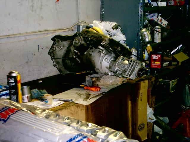

Waiting on my buddy to get his friends dolly. I cant jack up the Camaro here at my apartments. Ill get busted. Plus the asphalf is very soft here. Thats my first on my check list though.

Originally Posted by regal301
YOUR A MOD ??? IN A TECH FORUM ??? SERIOUSLY ?? YOU OBVIOUSLY HAVE NO CLUE WHAT YOUR TALKING ABOUT....... THERE WAS NOTHING DIFFERENT ABOUT THE 700R4 THE VETTES GOT IN THOSE YEARS,OTHER THAN THE CALIBRATION AND TAIL.
The V casing has no mount pad for the cross member. This is because the corvette does not use a cross member, but instead holds the transmission in place with the cbeam. Please see attached pictures.
YOUR OUT OF LINE
I believe you just called me an idiot.
-- Joe
Attached Thumbnails Threw another dang rod-1.jpg   Threw another dang rod-2.jpg

Re: Threw another dang rod
Originally Posted by Chevy86 IROC-Z
anesthes, enough is enough. Im gonna post a copy of my purchase of the 700R4. Now please note the phone number to Transplant Transmission.
I'm actually curious how you bolted it up. You are taking this the wrong way.
I had a couple of C4 vette casings a while back, which I could not use in a fbody because it didn't have the cast boss. It took me forever in a day to get rid of them locally..
Now that I remembered and have cleared up the confusion, can we just get back to the topic?
Yep. I also had a situation a while back with a 700R4 that was making some noise like yours. On the topic of flexplates and flywheels, something hooked onto the flexplate and sawwed through the bell housing inside of maybe a minute or too. Watch your feet!!
Hope you find the problem and hope it's minor.
-- Joe
