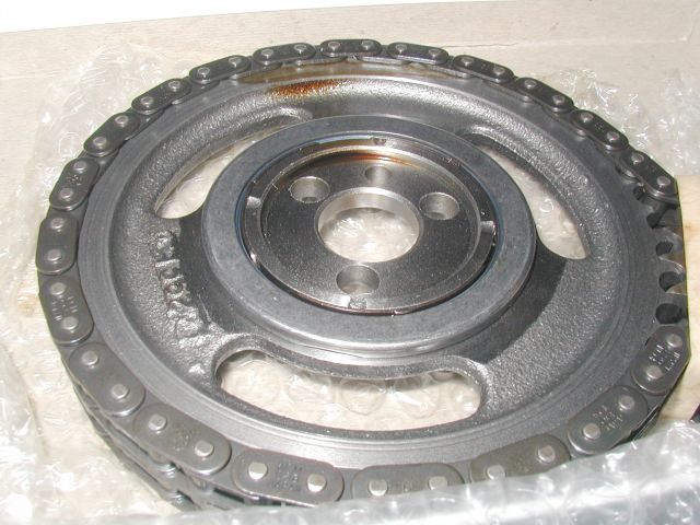

1. Of course not. It's not a factory part. Look at Cloyes, Rollmaster. I have a Crane one laying around also but I doubt you'll find one of those any more.
https://www.thirdgen.org/forums/atta...g-set-w-thrust
2. Never heard of such. Works fine in my car and every other one I've come across. There are problems putting them in certain blocks, most of which happen to be from newer computer-controlled engines, because a cople of casting "features" interfere with them. Nothing a die grinder won't fix in a matter of minutes though, and nothing directly related to the computer in any way.
