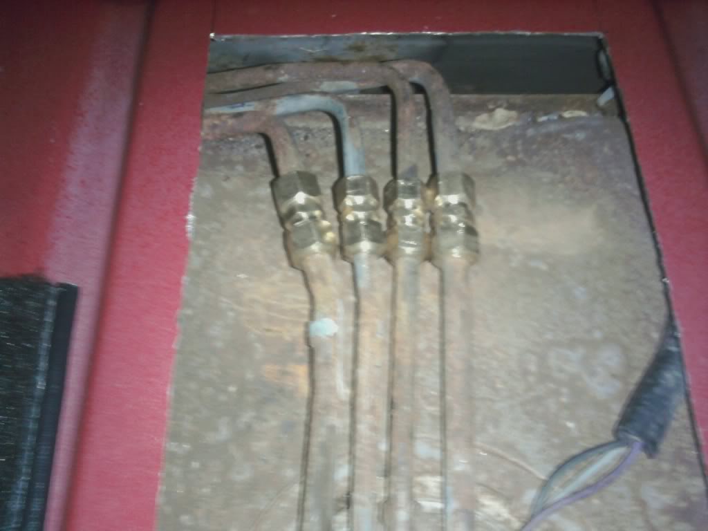

heres a few shots of how i did mine..
i never took finished pics, but i made it hinged, and used those rivet in fastener things along the sides and edge, and used rubber stripping to weather seal it.
i dont think cutting the hole in the trunk is ever an option to do this kind of work, unless the car is a stripped out race car that still uses an intank pump. IMO.
however, props to you for taking the time and doing the access job correctly and cleanly. no rubber hose splices either, i like how that was done. Good job.
