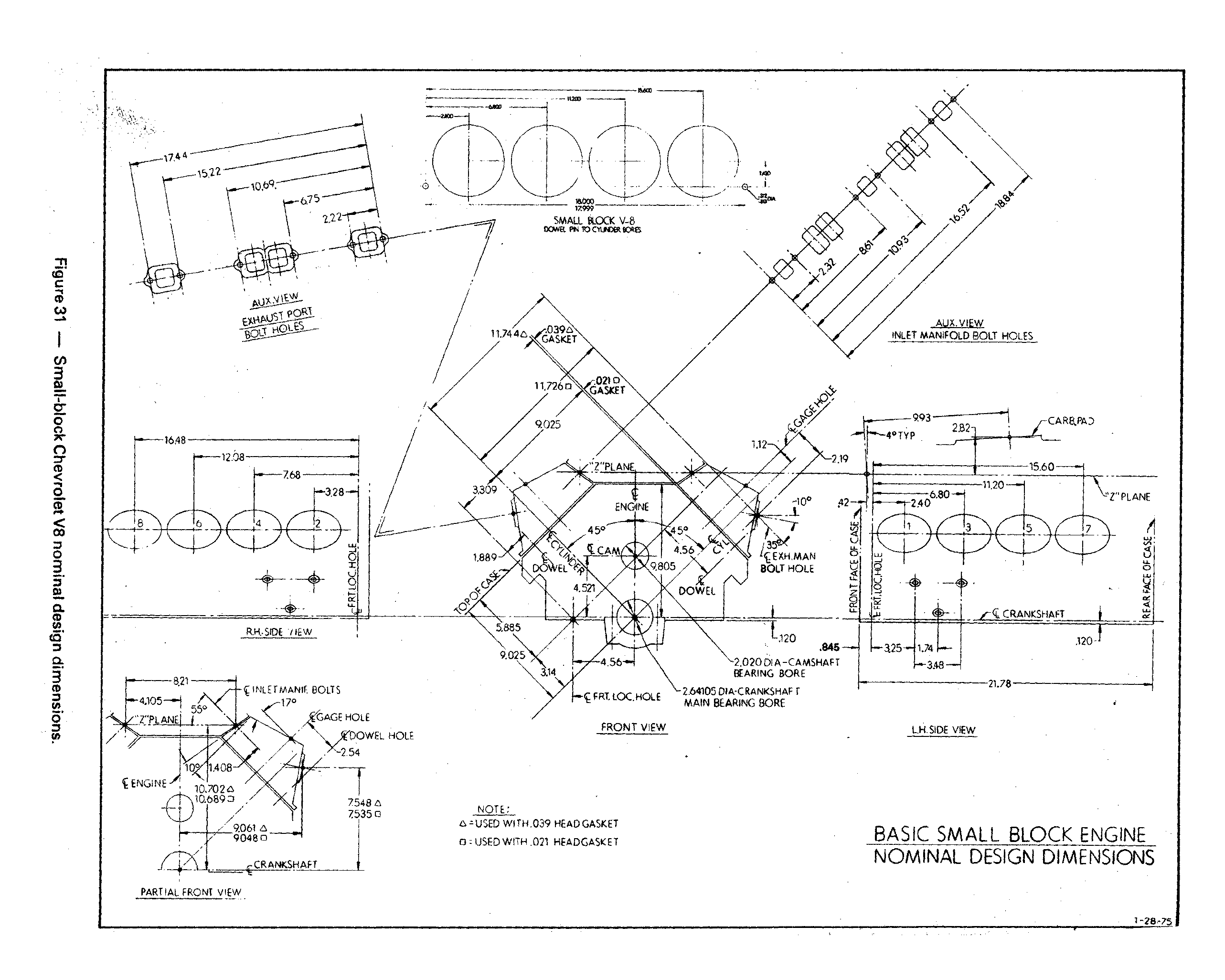

This should help you out. Found it while working on my project. http://enginedev.blogspot.com
