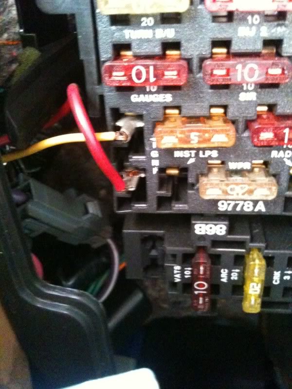

Ok, so I was looking through older threads and saw someone mention the ign space on the fuse box. They said that instead of a fuse there was supposed to be a red wire and a yellow wire there. I looked and I only have a red wire. Is there any reason why someone would remove and reroute the yellow wire?
I bought this car from someone on this forum and I'm starting to realize that several things on this car have been rigged. I don't know if the person I bought it from did it or what but someone has really screwed this car up.
It has a new engine, new transmission, new suspension, new interior, new exhaust, new radiator, and now a new starter. You would think it wouldn't give me so much trouble. The whole damn car is practically new. I'm about ready to sell the damn thing and buy a Mustang or a Japanese car.
I've attached a picture of what I assume the fuse box should look like. If anyone knows where I might be able to find this illusive yellow wire and why it may not be where its supposed to be I would really appreciate it.
