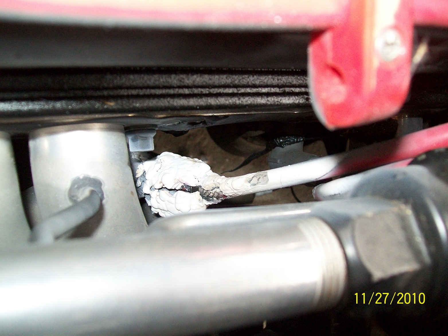

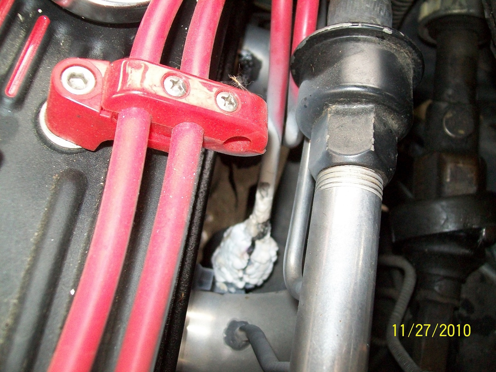

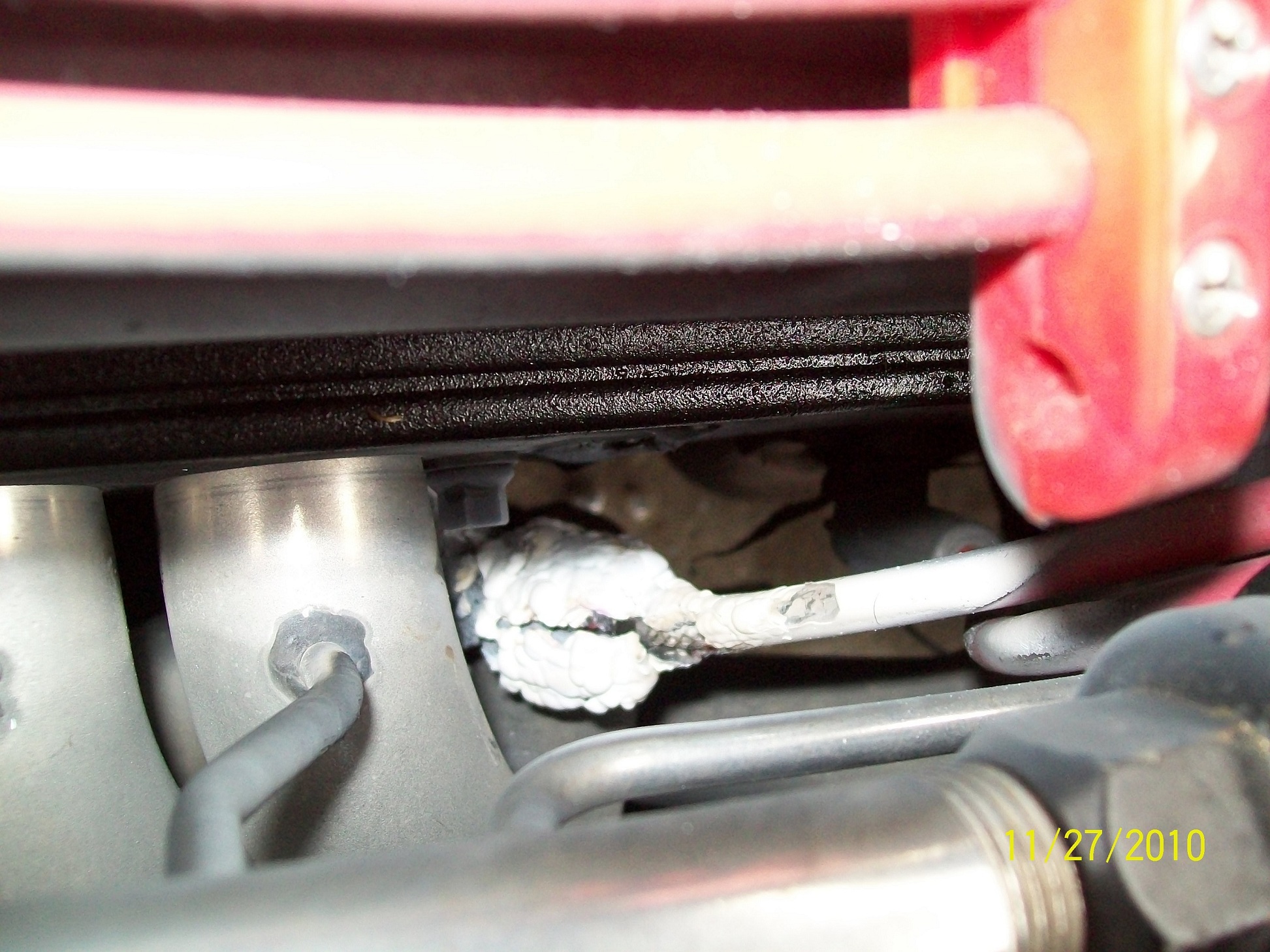

Has anyone seen this happen to a spark plug wire? Car is 84 T/A, carbed. Ran it all summer and never had a problem. The only thing I can think of is that is started when it got cold and I let the car run on high idle for 5-10 min to warm up and it gets to hot. Only that one plug is doing this. I'm ordering anew set of MSD plugs now. Does anyone have an idea of what could cause this? Running hot obviously...but just hot or could I be having something else going on?

Retarded timing or lean mixture will make your exhaust run hot. Especially during your warmup high idle. Can you see the headers glow if you run it at night? Mine were red hot and cooked my wires right after my engine swap before i got everything adjusted.
And is that your number 5? I think that was the first one to start glowing on my own.

Possibly the terminal inside the boot wasn't making good contact causing internal arcing and going through the insulation to the outside. Question, in your pictures what is below the wire that is also cracking?
Because there's not much room to route wires away from my SLP headers I use boot insulators like these. http://lh5.googleusercontent.com/pub...yy61vfPZsx=s90 The next time I change wires I'm replacing these with 12" insulators.

That's the rest of the wire/boot. It's completely blown up like that. Bubbled up all white and crusty and rotted away from the inner wire. The car still runs fine..for now. I'm sure it'll start arcing soon enough.
I have a set of those wire protectors but I cannot get them to fit over the boot ends of my MSD wires...so I wasn't able to put them on. if I could figure out how to take the boot ends off I could get them on but I haven't been able to figure it out.

I'd swap that one wire out with another, see if it happens again. Looks like it cooked itself from the inside out.

Just a thought, but I had a similar problem with my '89 Firebird (2.8 V6). Turned out to be a leaking exhaust gasket.

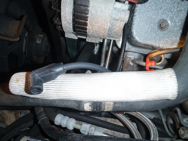

Here's some pictures of mine.
Insulator without the wire in it, the ring is on the left.
Wire shown on the outside.
Wire and insulator installed.

The new wire set should be here today or tomorrow. I"m going to swap out that wire and put the heat protectors on them to see how that helps. I wonder why it waited until now to do this. I've been running the car since July with these plug wires and nary had a problem till I saw this last week and I am under the hood at least once a week.
