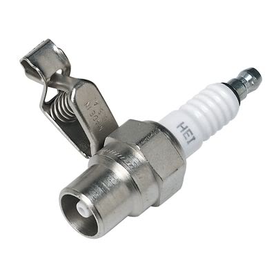

Everything passes the ohms test except the coil. I tried 3 different coils, one being new and neither of them could pick up resistance between the rotor button and the GROUND strap, and the TACH and the rotor button. I used this ignition tester:
I grounded the tester to the intake manifold where the carburetor goes and it doesn't make a spark out of the end.
I only have 1 distributor with me. It's not my old one that worked.
But back to the coils I was talking about... see how that just doesn't make any sense? with my distributor there's something not right with the coil. And I haven't tested the ignition module. These 2 things are the only possible parts that are bad. If I could clear my coil problem then I would test the module. lol my sentences are terrible today for some reason.
