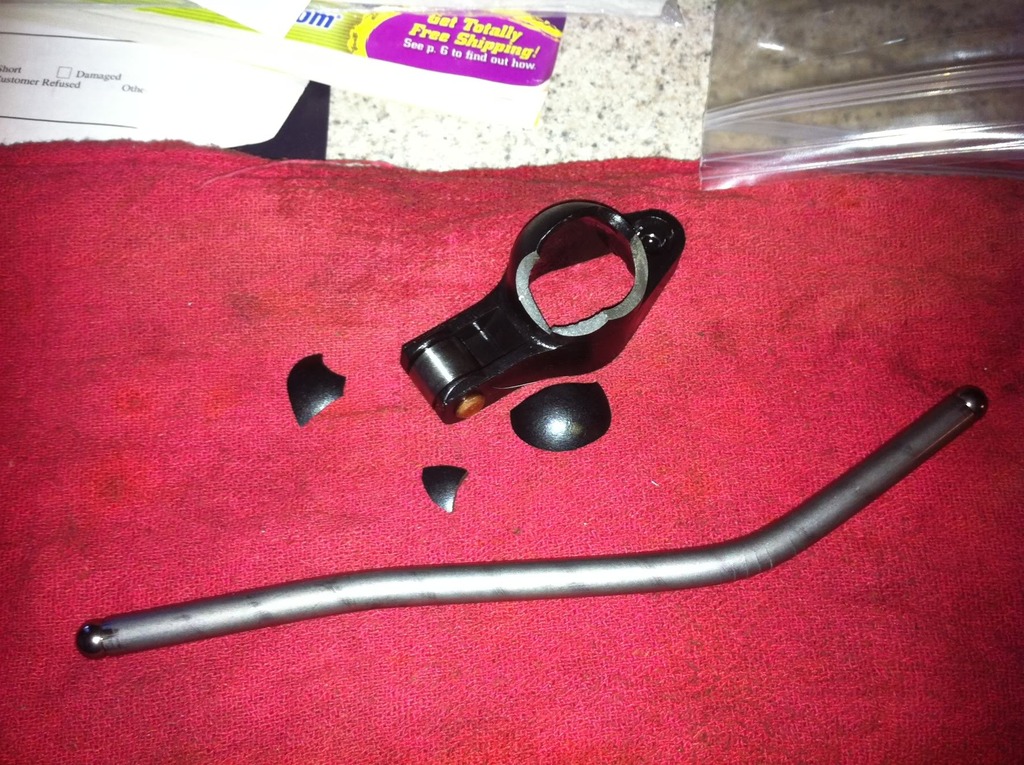

Re: Cheap self aligning roller rockers 1.6
NO!!! dont buy those!!! They have very bad quality control on their rockers. There are plenty of post on the net about how crappy they are. They can break real easy with a high lift cam. How do I know this? I bought a set of there 1.5's and heres what happen to me last week..

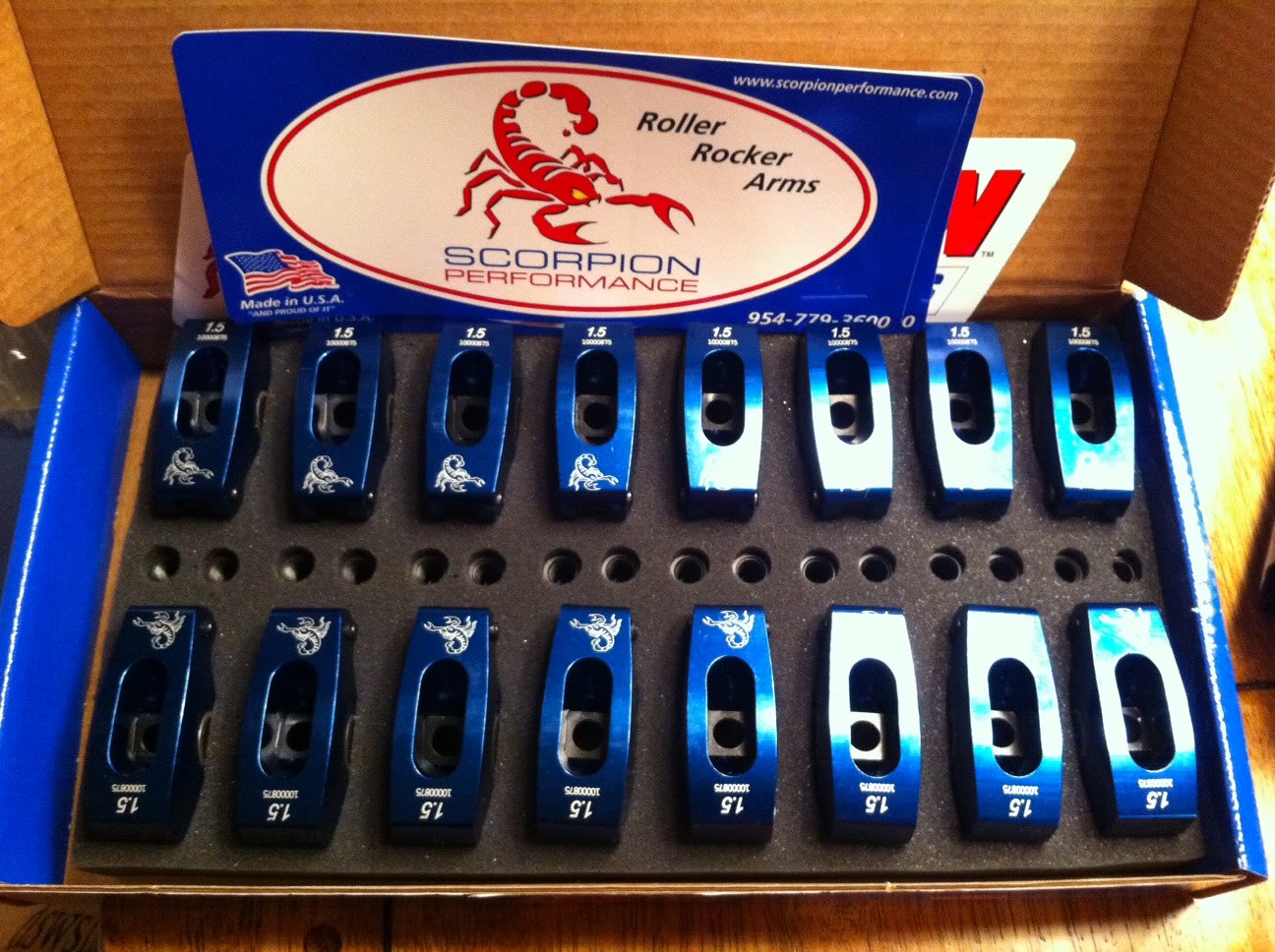

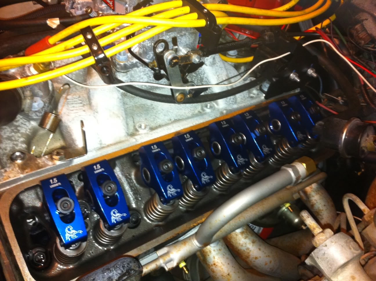

Yeah, thats a better way to go, heres the set of 1.5's I just picked up...
the way it bent the pr,it looks like another problem,would a broke rocker cause the pr to bend like that?
the rocker took out the pushrod in the valve next to it, I think one of the pieces got jammed some where. No other damage was done.
