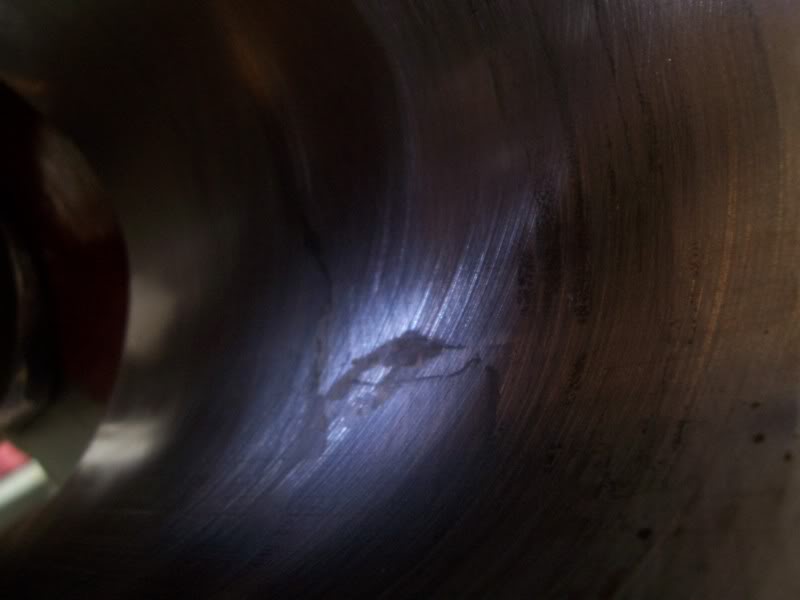

This is what 45 minutes of run time looks like on cylinder walls:
Note the bore at the bottom. Its not a lot, but remember its only had 45 minutes of run time on it.

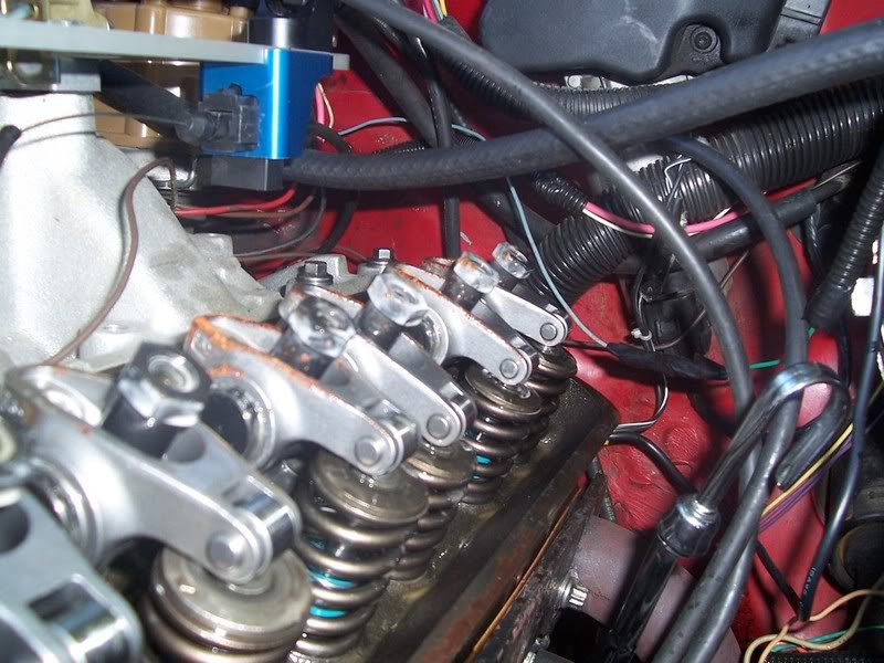

Taking longer than expected, as normal, but the rotating assembly is in, rings all filed to fit, clearances all checked and good. Saturday I'm hoping to finish it up minus pushrods. Gonna measure for the length then order.
A better picture of it, I cleaned it up a bit for the picture. To brody, again, notice the scuffing towards the rotational axis of the wrist pin towards the bottom of the picture.
The engine was in a friend's car. he put a lot of work into it and had it rebuilt and he had to go .060 over on it. He wasnt happy about it but the block had history for him so he dealt with it. After he got his engine together, he had some issues with exhaust/fuel getting into the coolant. He blamed the block and threw all of his stuff into a 305 block. The problem was still there, and he found out it was his 113 aluminum L98 heads that had a crack in them. The block was apparently fine, but he had already spent money getting everything set up for a 305, etc. So it was easier for him to sell the 350 block with 3k miles on it as a good working block with fresh machinework than it was the tear down the 305 and rebuild the 350 again with new heads. And he's well known here for having a 12 second 305, so that 305 was pretty quick, he wasnt missing the 350 too much.
I got the block and had it rehoned and ran it with some Vortec heads. Had a hard time getting everything working - my first set of heads were junk, so I had to put new heads on it and the bore/oil looked fine after that initial attempt at cam break in. After the new heads I finished breaking in the cam. Went fine. Oil looked fine when I changed it after break in too. After that I drove around the block to start adjusting the TV cable (it had a 700r4 at the time) and adjusted it and parked it for the night. The next weekend I set aside a day to try to get the TV cable dialed in right, and noticed a lifter tap - so I decided to pull the valvecovers to adjust the valve lash, and this is what I found:
I think just driving it around the block cracked the cylinder wall because it was .060 over. That's why I always tell people to avoid .060 over engine blocks these days. Apparently it was fine before the 3k miles before it was disassembled, looked fine before and after the hone to the guys at my machine shop, and it looked fine to me too, even after it had a few minutes of run time on it from the junk heads. I pulled off the crap heads and it still looked fine. And the oil was clean after I finished breaking in the cam with the new heads too! I think the wall was fine for just running the engine in neutral, but just too thin to last when it was under enough load to have to propel a 3300 lb car. What I wonder is how long it would have lasted if I hadnt rehoned it for my new piston rings.
By the way, my buddy who had this 350 block and threw together a hodgepodged 305 out of scrap parts, he ended up running 12s with his 305 even after he had to ditch the Aluminum L98 heas for 416's.
And it was a happy ending for me too, really, because I ended up with a 1 pc RMS block that I could bolt a T56 up to easily. I didnt have to worry about one of those crazy conversion flywheels.
I also want to point out that my cam survived 2 different break ins. I think something happened with the second break in too taht made me abort it out of paranoia. I ended up pulling the manifold and inspecting each lifter and putting break-in lube on each of them. But the cam survived, still running strong.

Re: Engine needs re-build, and more power, any suggestions?
Heres my progress.
Old Aug 17, 2011 | 08:41 PM
  #48
InfernalVortex's Avatar
Joined: Dec 2005
Posts: 6,499
Likes: 31
From: Macon, GA
Car: 1992 Camaro RS
Axle/Gears: 9-bolt 3.70
Im jealous.
