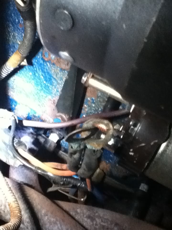

ok well climbed under it and here is the condition of the starter wires, as you can see, one is spliced from black to orange, and the main one from the batt, is very green.. could the spliced wire or the corrosion be the draining issue?? ill clean the cable but what about the split wire? i can untape it and check it out but i dont even know what its for.. and how the hell do i check the grounds on the back of the block on the passenger side??? i cant see them from under or over top, drivers side ones seem good

The two smaller terminals connecting to the fusible links don't look good - those are the two main feeds for the whole car. Any green crud is a dead giveaway = corroded copper. Cut those two off and replace.
There also seems to be green crud on the main cable to the batt, I'd replace that too. I assume also the various ground cables are probably in the same condition.
i will replace them tomorrow, thanks for the reply. these are actually the only corroded wires i can find, the ground to the fender and the neg ground on the bottom of the power steering pump looks good. cant see the ones on the back of pass side block, but drivers side block looks good to

If replacing the obvious bad ones doesn't fix it, take a harder look at the ones that look ok. I got bitten by this a few months back, problem turned out to be a fine looking neg battery terminal. Discovered this after I decided that finally replacing all of the 25 year old original cabling, was probably a good idea.
Put a bit of pressure on it, and the end of the terminal shattered like china, full of corrosion.

You can get a replacement main batt cable (from battery to starter) for like $10 at AZ of one of the others. Do it.
There should be a copper, non-insulated ground cable running from the rear of the passenger cylinder head to the fire wall, near the HVAC. If it's missing, bolt a replacement cable in it's place. You can bolt it to the rear of the head using one of the tapped accessory mounts and to the firewall using a large self-tapping screw (if you can't find the original mount point). Guage size doesn't have to be as large as the batt cable but close. If a suitable cable is in place on the driver's side, you're fine though.
Remove all of your other ground cables and clean the terminal ends and the mounting points. Reattach with a little grease or anti-corrosion. Should be one to the alternator bracket and one to the fender next to the batt.
There should be at least two smaller gage wires coming off the starter terminal where the batt cable connects. One should be the hot for the rad fan and the other to the fuse box. If you need to you can cut these back til you find good cable then solder a replacement cable in and heat shrink. If the cable past the ring terminal is good (still flexible and not corroded) you may be able to simply clean or replace the terminal. These cables are subject to a lot of heat though and may need to be spliced. Make sure you run any replacements through the metal tube to the starter to protect the new from exhaust.
Do not be tempted to crimp connect wires of this size.

ok, cleaned all connections going to the starter and battery, also ran a new wire from the back of passenger side head to frame. charging the battery now, then i will throw the new alt on and see if its ok.
