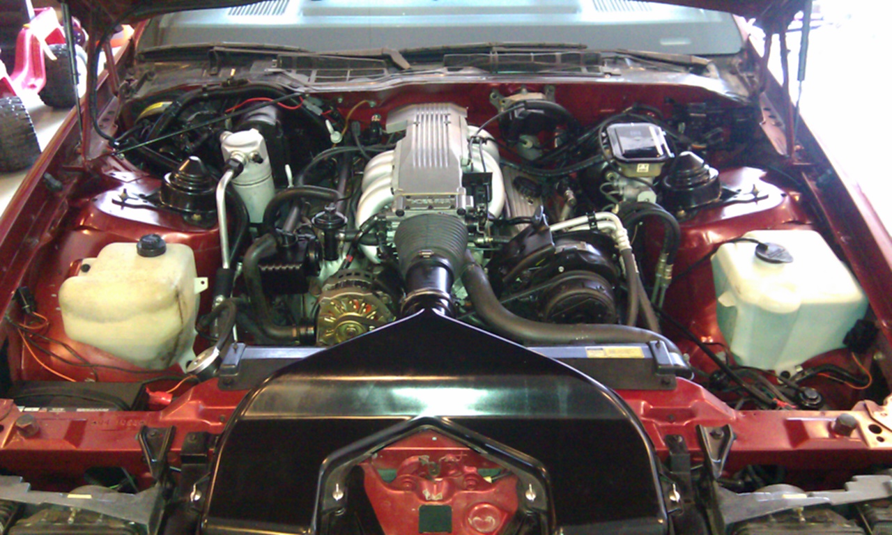

Hi Guys! Been I while since I have been on the site, & I wanted to re-visit a problem I have with my 1987 Iroc 5.7. The car is all original with 60K on it. I have owned the car since it was 4 years old. I don't drive it much at all, in fact it sadely sits in storage sometimes as much as 3 years without being driven.
Anyway, the car runs & drives very well, but the problem I am having is upon a cold startup (50-70 degrees outside) is idles very rough for about 10+ seconds. If I start it without touching the gas pedal, it will just barely stay running & sometimes will stahl out. If I play with the throttle for the 10 seconds or so, it will smoothen right out.
the weird thing is, on the times that it is stumbling it will hit a point after 10 seconds or so, where its almost like a switch is flipped & it idles up & smoothens right out. It will then run perfectly like it always did years back.
So my thinking is that there is something that changes in setting from initial cold start up?
What I have checked is the fuel pressure & TPS voltages. TPS is at .52 (I think that is close?) fuel pressure is good & consistant.
Thanks for your thoughts & ideas
