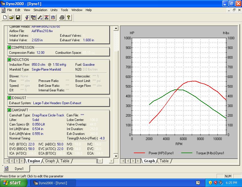

for a race application on a limited budget, if your serious on making a 350 SBC run it needs to run effectively in the 4000rpm-7300rpm power band and since your on a budget that means a solid lifter flat tappet cam

BTW your bound to get some guy who is used to building street car engines telling you 210cc heads are too large, that would be true on a street engine but even the 210cc are a bit small on a serious race combo
just keep in mind you can,t slap just a few parts together and get it to work, you can,t use the stock compression or rear gearing or converter and you can,t do things half A$$#D and expect to get good results
do the parts selection properly and assemble everything correctly and the software dyno makes its wild guess that youll see something like this in flywheel hp
