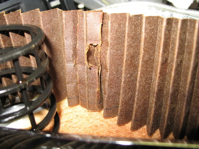

I avoid all E-Core type oil filters (plastic cage). Here's a couple of E-Cores that came off two different vehicles in my family fleet. E-Cores include some ACDelco and some Super Techs. YMMV:
Super Tech 3614 removed from a 1998 Lexus LS400 - Unsupported filter media. If that piece of filter media broke off there's noting to prevent it from getting into the oil passages.

Same Super Tech 3614
