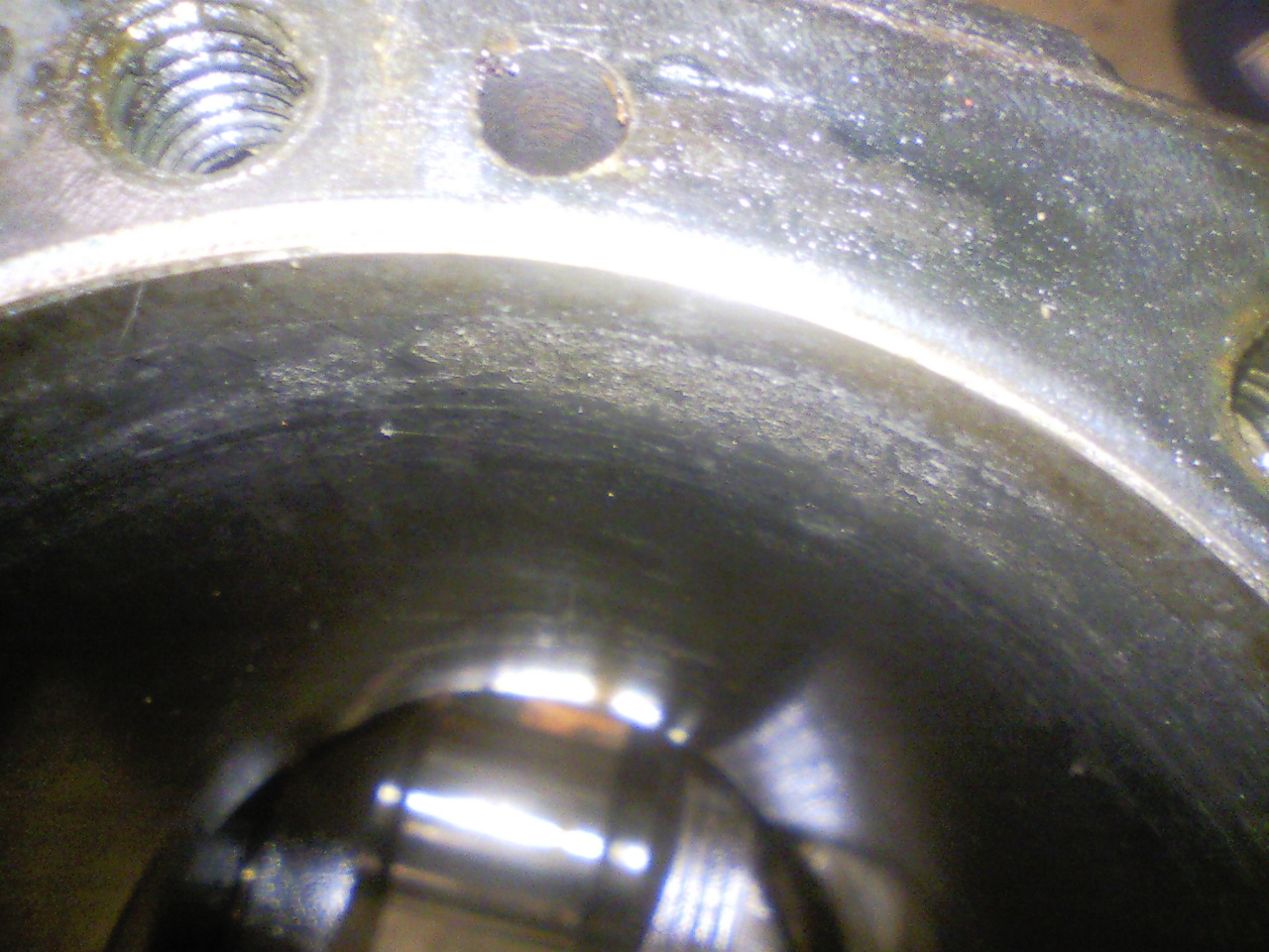

My experience has been that coolant passages develop a lot of internal build-up of corrosion/residue from sitting for prolonged periods, especially if Dexcool (orange) coolant is used.

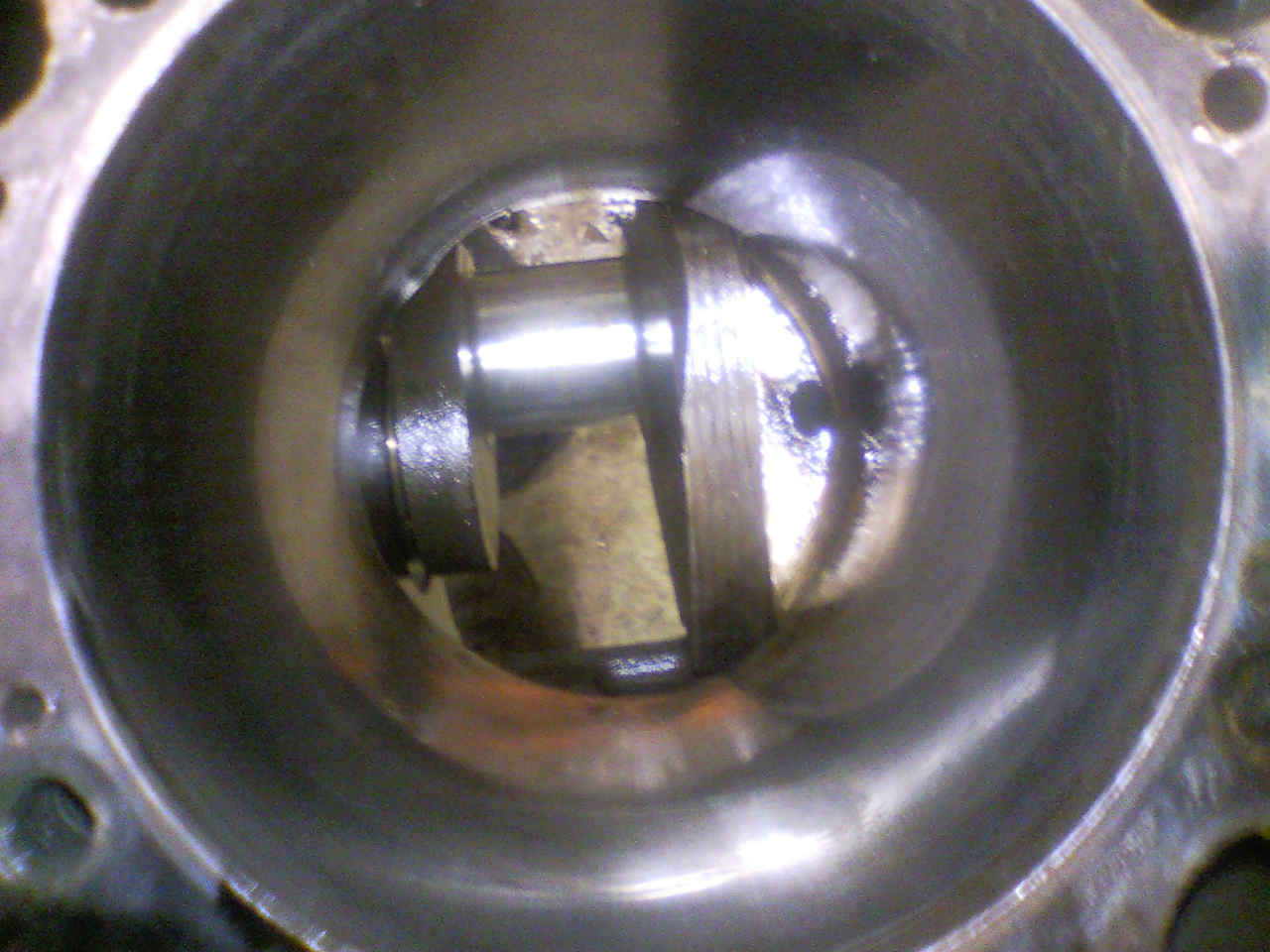

I just finished talking to the machine shop. The cylinders only have .006 thousandth wear. So they are going to be able to just hone it. It was already .03 over. Unfortunately the crank journals need to be takin to .02 under. Both the main and the rod journals. They were already .01
So at this point I told them to go ahead and do all of that. I'm now in the process I'd deciding what I want to order in terms of rebuild kits. I've found one that I'm interested in on summit. It has the hyper pistons. There isn't a complete rebuild kit available with forged and even if there was it would be out of my price range. One of those things where I would like to get them but just can't. Anyways here the link to the kit. http://www.summitracing.com/parts/FEM-MHP139-322/

It was a remanufactured sbc 400. It has the stock heads that were found on 400s of that time with the 76cc heads. So the comp. Ratio was in the 9:1 area. It had a full tank of new gas in it. I think the cause was from a combination of things all caused from the motor sitting for so long. Any thoughts/comments on my last post guys?

400 blocks need to have steam holes drilled between the #3/5 and #4/6 cylinders to allow air pockets to move from the lower side of the water jacket to the upper-side and on up into the heads. Otherwise a large steam pocket will form in that corner, and steam gets much hotter than the coolant and will not remove heat from the metal there. Have your machine shop drill the block for you.

Ok, I will call the machine shop about that tomorrow morning. I also need to take them the rod caps and nuts so they can check the rods.

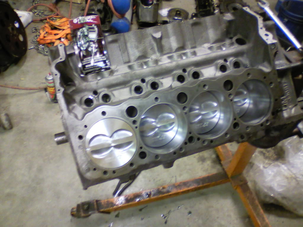

Re: Piston damage need some opinions(Update putting motor back together)
Well ive got the motor back from the machine shop and got the crank, rods and pistons in tonight. Heres a picture of the product of tonights work.
