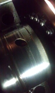

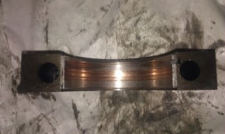

so.
went out driving today.
worked fine for a while, but I noticed som noice from enginge . But couldn'n define where or what it was....
in the evening i did get som oil leak from front sealing on my crank.... bad bad bad..
so I opend my oil pan ti inspect off my front bearing.. this is what I found..
but what is this middle shims very thin, on this picture:
ned a new crank and allot off work...
