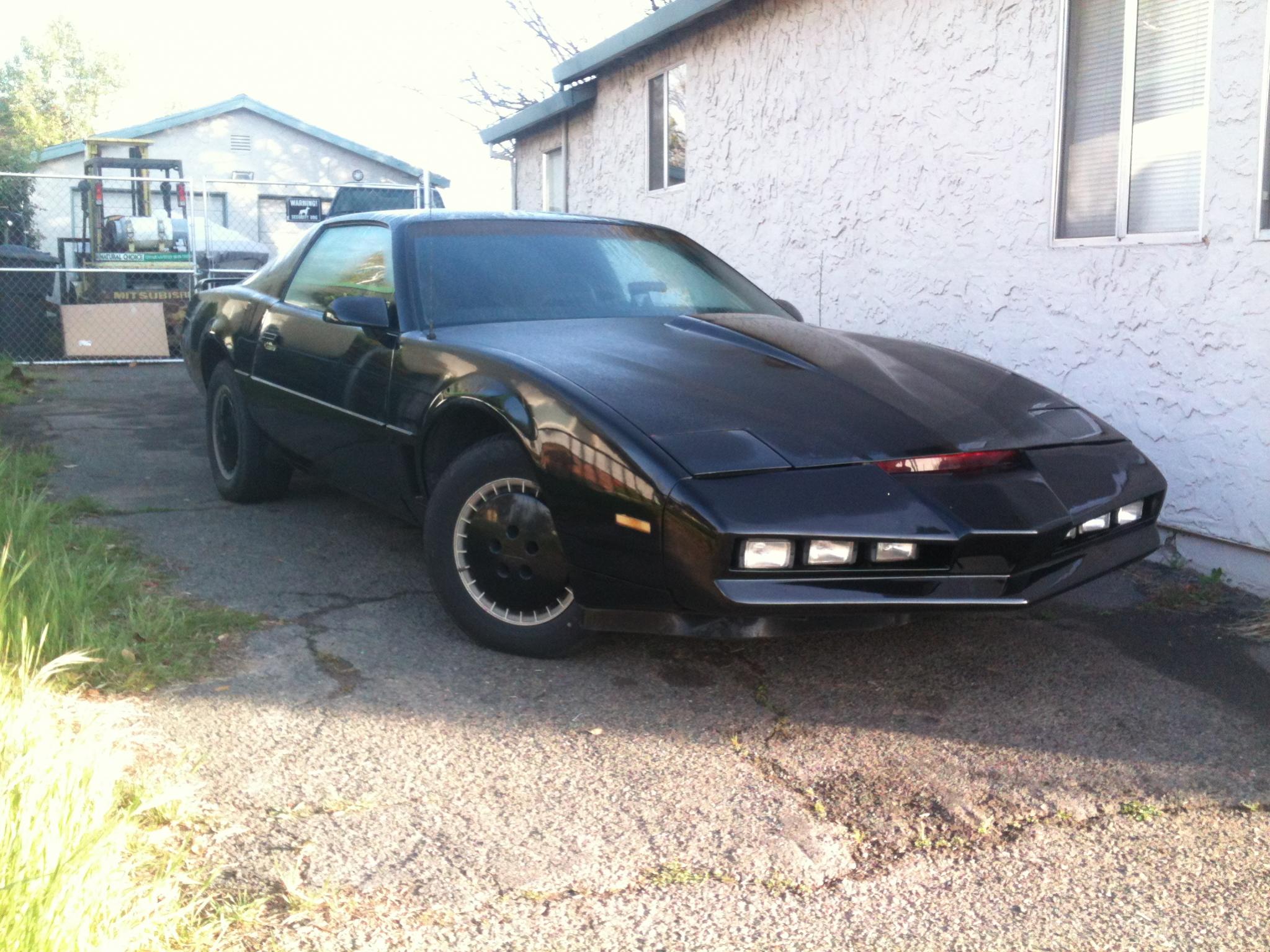

see this guy?? thats me scratching my head!!! 82 pontiac firebird. So anyone know how the shift interlock works or how its wired?? I can start my car and rev it up but it wont shift out of park. I took the center console out and disconnected the shift interlock cable from the shifter... its shifts now but... now the key gets stuck sometimes and wont come out!! I feel like the car is laughing at me or its just tired and wants to die.. Can anyone help me figure out this new problem?? Im thinking its a electrical or mechanical problem. Is there a solenoid inside that cable bracket on the steering column? what does that rod do up to the switch?? I cant find a wire diagram anywhere for that interlock. Lots of questions... any help would be helpful!!! Thanks
