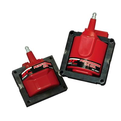

My set-up will be all MSD Street Fire:
MSD-5520 STREET FIRE IGNITION BOX $119.49
MSD-5502 STREET FIRE DISTRIBUTOR CAP AND ROTOR $22.95
MSD-5526 STREET FIRE IGNITION COIL $32.95
MSD-5570 STREET FIRE SPARK PLUG WIRES $38.95
Free shipping and I had $20 Summit bucks! Blows away anything locally unfortunately. I plan to get AC Delco spark plugs at O'Reillys. I just think Street Fire is the most bang for your buck as far as a 305 TBI goes.
