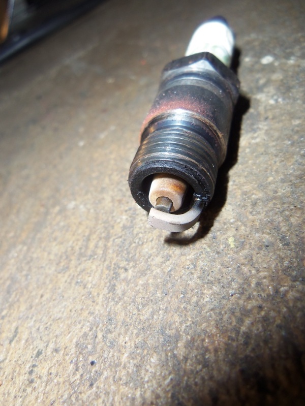

i think you have enough signs of a bad head gasket...befour u open the engine u should do compression test on all cylinders to find the bad one...sometimes its hard to see when u open the engine and look for signs at the gasket...cylinder that burns coolant looks washed and clean...good luck

Before you start thinking it's a blown head gasket (which it very well might be) you should take it to a shop and have them do two tests on it- one is a pressure test (to see if it's got a leak somewhere- like past a head gasket and into a cylinder) and have them put the "coolant sniffer" on it (which smells for traces of exhaust gasses in the coolant). If it fails one or both, and I think it will, it's time to take the motor apart.
And you may find the problem isn't even the head gasket but a crack in the head or block. They can sometimes do OK when cool but open up more when they get hot.

As far as a compression test, really need to get one done. I did however pull the plugs prior to the video I posted and found no evidence of coolant exposure. Only thing that kinda seemed out of the norm was I guess hot spots on some of them? I'll attach a picture of that as well.
I did do a vacuum check probably about a week ago and everything looked good. I was getting the normal vacuum and when I gave it throttle it'd drop to zero then shoot up to about 25 then go back to normal. I may do another test again and get that on video. I'd imagine everything helps at this point but I won't hesitate to pull the heads.
Here's a pic of one of the plugs. Mind you. These plugs are a week or two old and don't even have a full mile on them.

Thanks for the input guys.
I'm definitely gonna look into my valvetrain on the engine. Waking the engine up from a long sleep like that probably didn't take so well with a couple of things.
But turns out the EGR solenoid was beyond bad and was causing havoc. Unplugged it and everything smoothed out like butter. Ran it for about 20-30 minutes, drove around. Normal temps and the fans always kicked on and brought temp down. No SES light, no miss. I'm happy. Thanks for all the help!
