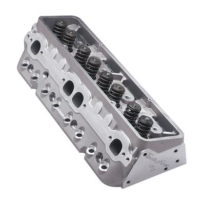

If you've talking about the intake bolts, they won't match a head with the 4 angled center bolts along the perimeter because TPI '87 and I believe newer intakes have vertical bolts.
The TPI intake bolt holes can be slotted to fit, but you'll need angled washers, or adapters to keep the bolt straight. You may find someone who makes the adapters, which is what I would use. Last resort would be to get an aluminum rod of the bolt washer diameter, bore through for bolt diameter and cut at an 18° angle to make your own, 6" rod should be enough to make 4.
Old Jun 27, 2012 | 09:24 AM
reconguy's Avatar
Joined: May 2012
Posts: 32
Re: Compatibility questions
So now I have to find out if the heads have those types of bolts.
Old Jun 27, 2012 | 09:29 AM
reconguy's Avatar
Joined: May 2012
Posts: 32
So looking at this pic I guess I do have those style heads.
EDIT~ So I cal TFS and they gave me a part number to the exact heads I needed http://www.summitracing.com/parts/TFS-30300006/ which just so happen to be centerbolt valve cover SHABAM
