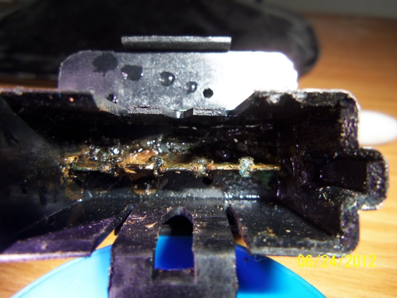

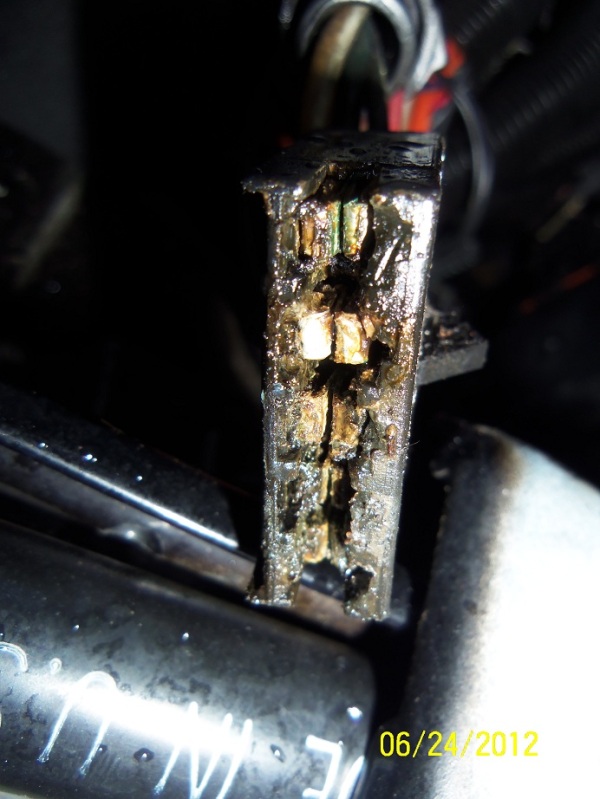

Think this would throw a code 33? Lol
Car decided to all of a sudden throw a code 33. Guess it couldn't take it anymore! Also, this is the original relay. Time some cleaner and new dielectric grease!

nows a good time to change to the newer style relay and pigtail.

Re: Think this would throw a code 33? Lol
It is hard too tell the angle he is holding the connector but it looks like the corrosion is on the power side orange wire or could be the relay ground either way that maf relay wasn't doing its job.
