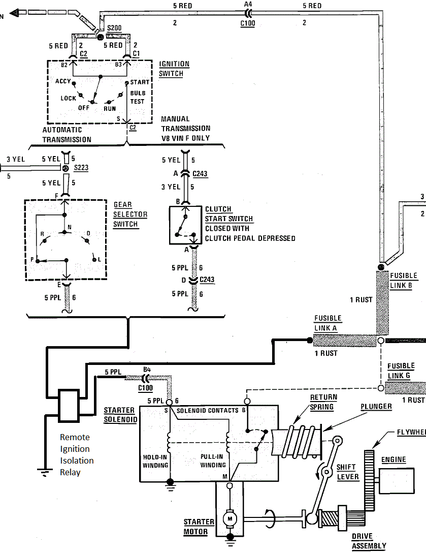

The Solenoid and the plunger within it that kicks the starter gear out to engage the flex plate ring gear cannot be relocated.
What can be done is isolating the ignition circuit from the starter circuit so that the Ignition, and Park/neutral safety switches and wiring do not carry any of the current load that they are normally subjected to.
This is the same method used to isolate high current devices, headlights, fans...etc. As can be seen in the attached modified diagram, the added remote relay reduces the current and therefore the heat caused by high current normally flowing through it.
Over the years the open area for air circulation under the hood has slowly disappeared even, in 4 cylinder engine bays forcing engine manufactures to solve a problem that could have been solved 30 years ago, with the addition of one relay, go figure...
However this will not help solenoids that are actually affected by "heat soak."
