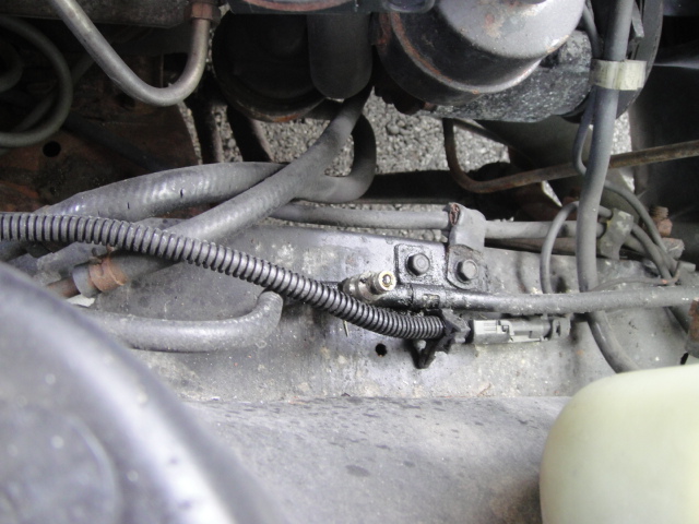

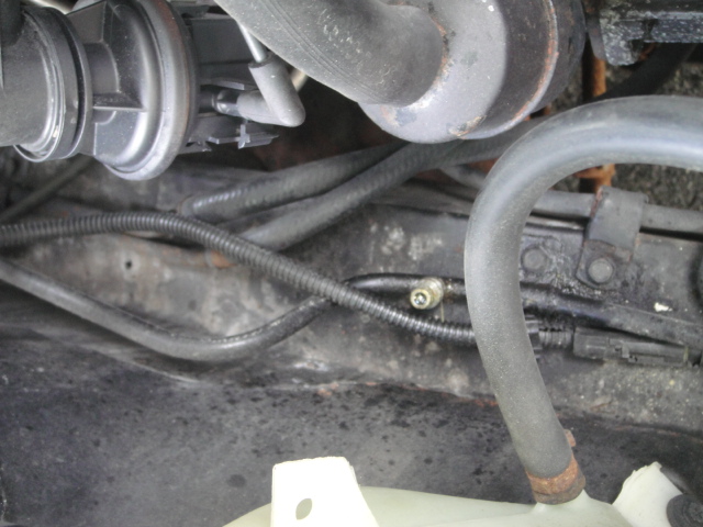

I have an 84 camaro and I am smelling a faint gas odor coming from somewhere in the engine compartment. When I started the car today it started fine but then cut out on me twice while operating it. I opened the hood and noticed that on the left side of the engine compartment there is a line with a stainless steel looking nipple that looks like "bubbling" fluid is coming out of. Is this supposed to happen? Do I need to replace the line? Is it just missing a cap?
What is this part/line even called?

That's the right side of the engine compartment. That looks like an A/C line, which would be unrelated to your fuel smell. No it's not supposed to be bubbling, and you don't have to replace the line, only the schrader valve, and yes it's supposed to have a cap.
You can find your fuel leak by using your nose or looking for a stain. I'm guessing it might be your fuel pump.
