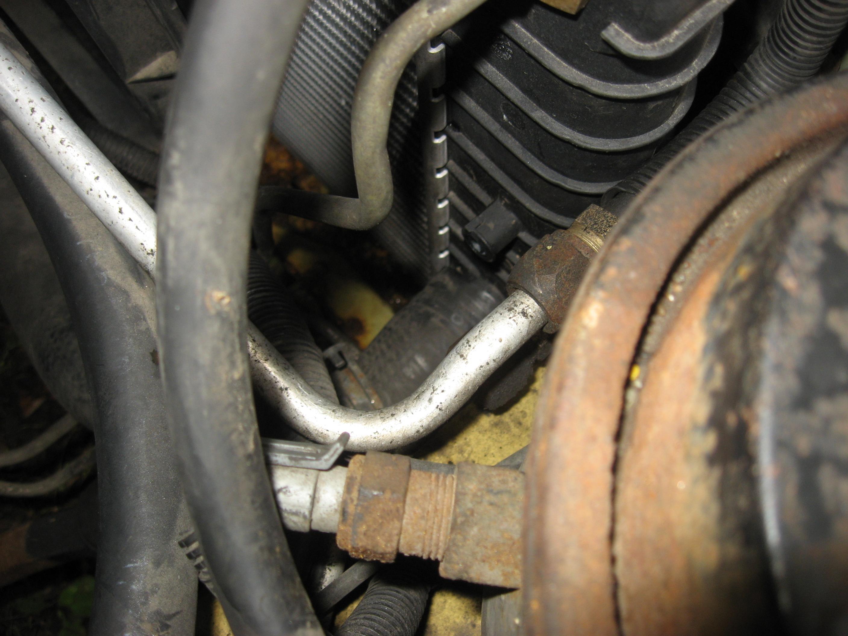

I'll go take a few pictures of what is leaking on the radiator. The best I can describe it as, is a nipple that looks like it should be plugged or have a hose on it. I barely touched it with the channel lock handles ,they slipped off the spring clamp and hit the nipple. I'll go snap a few pictures because they are better than my explanation of a vehicle that I'm not very familiar with yet.

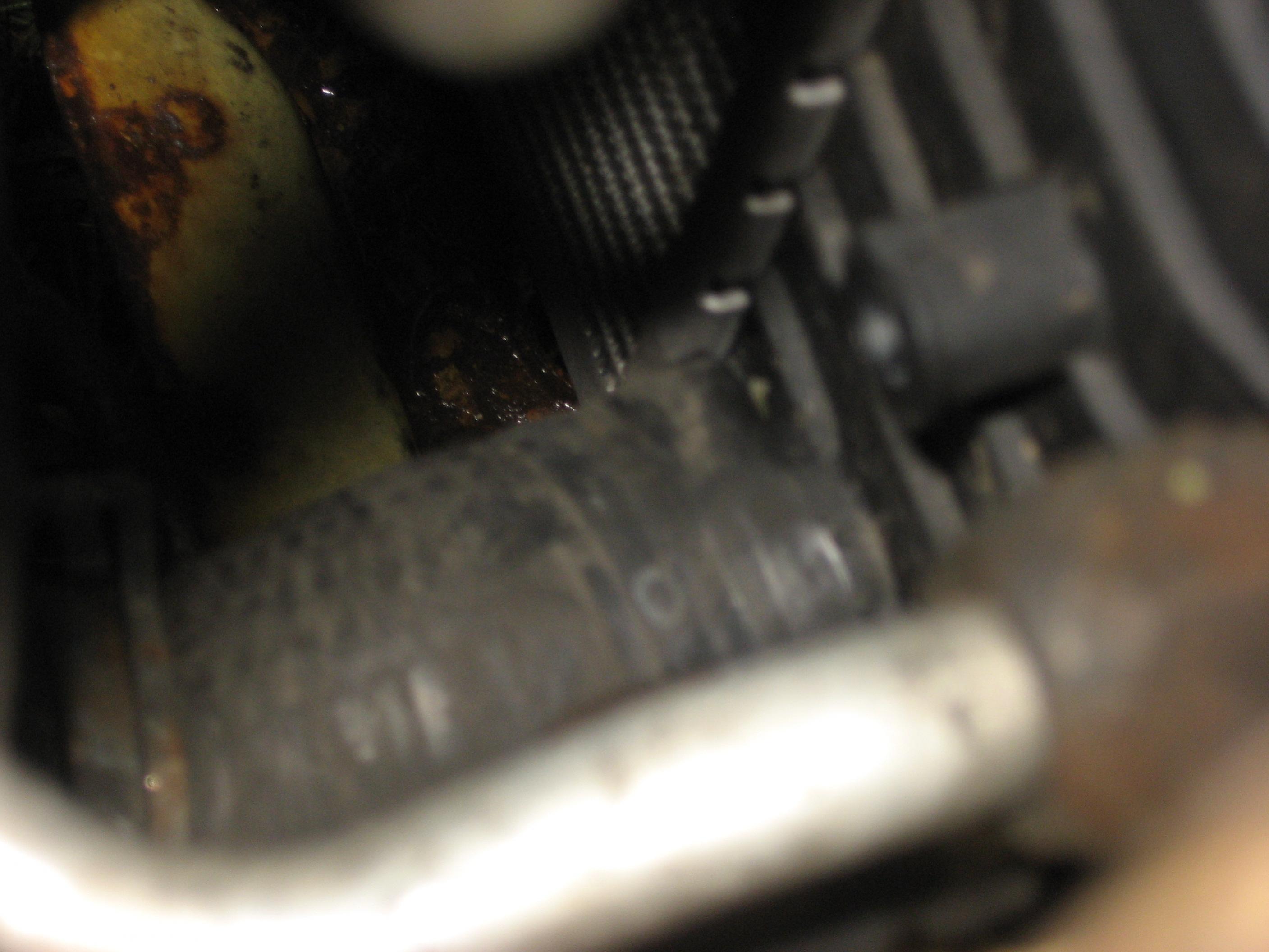

Btw, It was leaking here. I know because it was coming out like a stream, like the stream you would get if you removed the lower radiator hose, just out a smaller orifice. but here's some pictures to further explain.
Any ideas of what this nipple is ? or why it was shooting out coolant ?

Looks like a knockout where you'd put the "low coolant" sensor, in cars that use the same radiator (it fits ALOT of cars) but also have that system.
You can prolly put a cap over it, with an appropriate spring-type clamp, and never have to think about it again. They have caps hanging on cards in the coolant aisle at AZ, Advance, O'Reilly's, CSK, PepBoys, etc. Not to mention, REAL parts stores.

Thanks a ton for your help. I figured I would have to cap it because there are no threads, just wanted to be sure.
