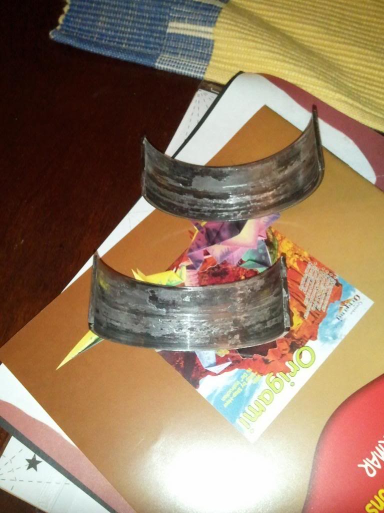

I pulled out the 305 in it to just replace gaskets and check everything was okay and inside I found on the 7th cylinder this

I know the block definitely needs to be honed maybe bored?

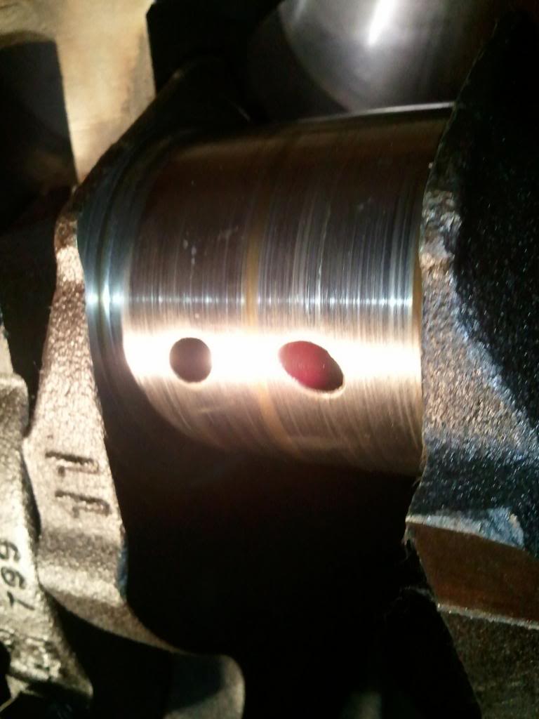

This is how the crank looks

That's classic "no oil".
Whatever you do, ascertain the cause of those running dry.
Can't tell if they spun in the rod; if not, buy a crank kit at any parts store, and leave the block and pistons and rings alone. If the rods got damaged, then it'll have to come apart; and if that's the case, might as well throw it in the trash if it's a 305, and replace it with a 350. Won't cost but about $50 more, and it'll be THE CHEAPEST FUN you ever bought. Years of enjoyment for the price of a couple of hours of clubbing or something.

Possible nothing else is wrecked, but I wouldn't put my money on it. rebuild it or...as sofa suggests and I did a few years ago, swap it for a 350. Hell, it's probably cheaper to start over with that than trying to rebuild the 305.
