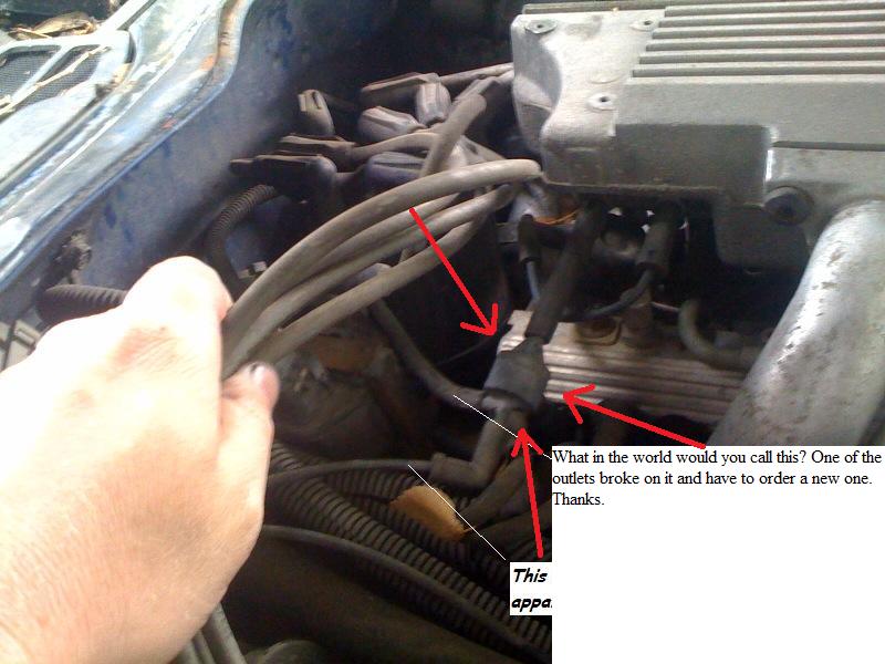

Please Identify This Piece
If anyone can identify this part, it would be much appreciated. Piece broke off of it so i can no longer attach a hose. Thanks.

check valve

Re: Please Identify This Piece
GM# 10135692, 15733271 or ACDelco 15-5421
http://www.ebay.com/itm/83-92-GM-Cam...sories&vxp=mtr
similar but not original
http://www.amazon.com/ACDelco-140566.../dp/B000C9F658
original
http://www.ebay.com/ctg/ACDelco-1405...alve-/99167065

Yup, check valve...
YOu can get em in the Help! section at AZ and such. All it does, is let vacuum go through one way, but not back the other; that way things that work off of vacuum, like the AIR controls, hold their settings if the vacuum goes real low, such as if the driver floors the gas.
