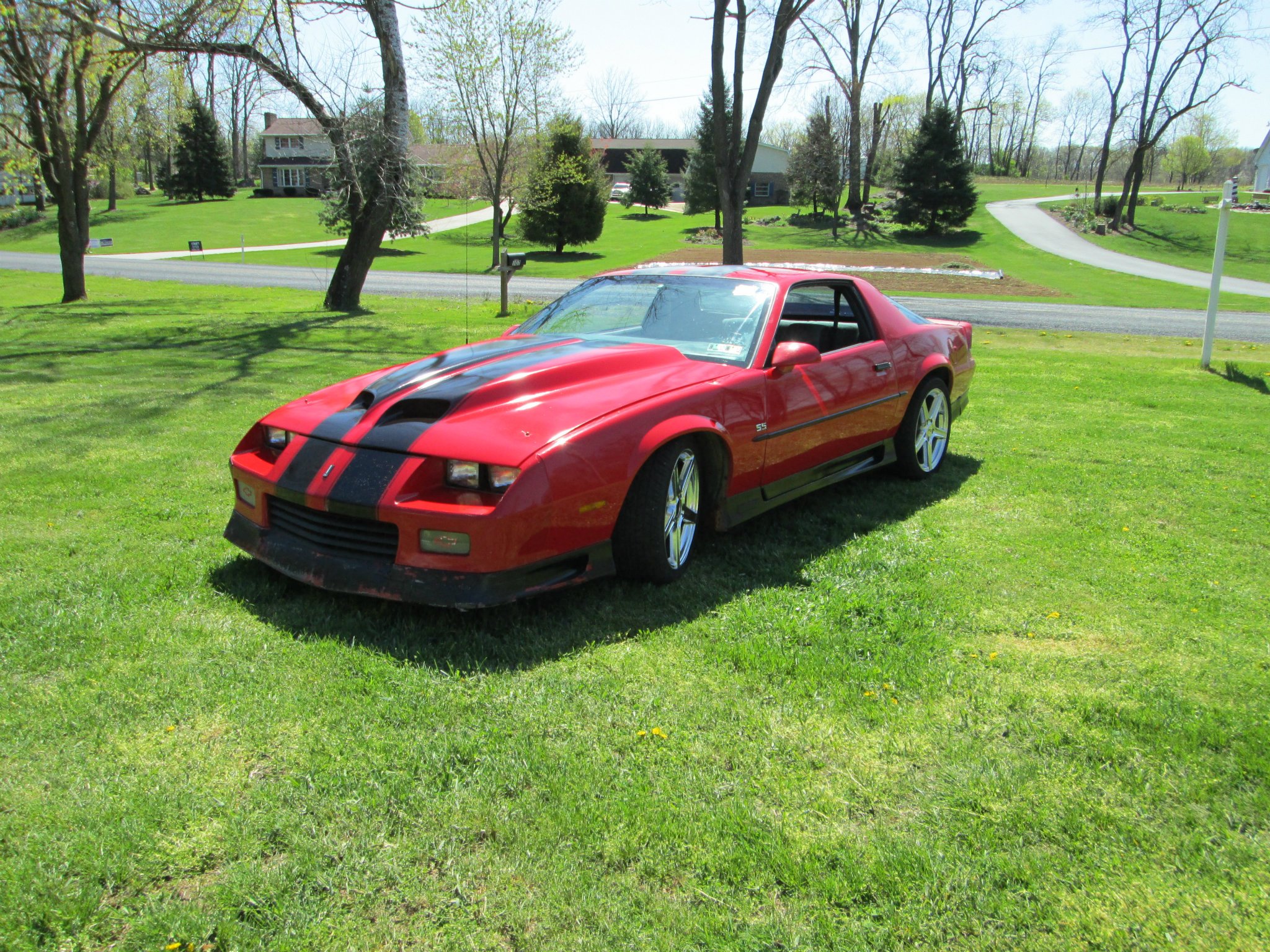

This is what the car looks like. I am gonna do black as the color for the engine bay.
