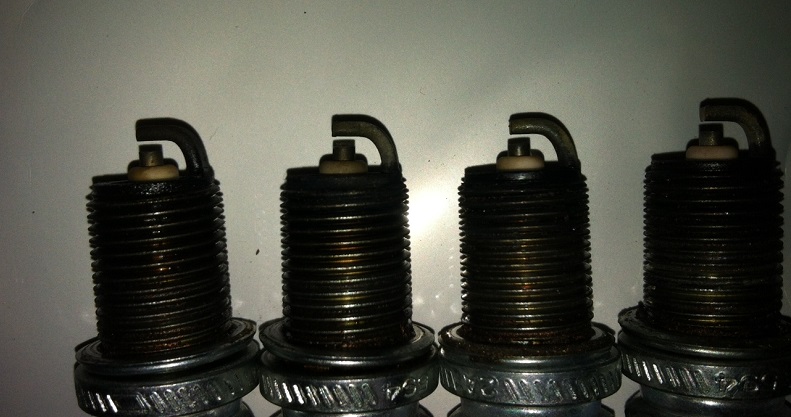

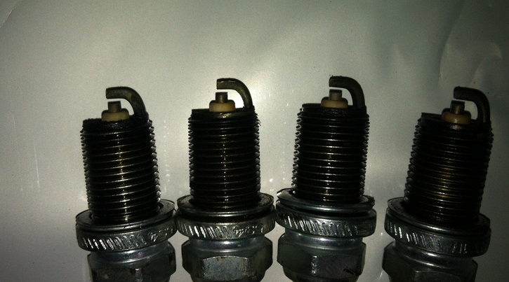

Do these spark plugs look ok?
I've been having a problem with a hesitation, figured I'd pull the plugs and check them out. They look okay to me, some seem to be wet though while others are dry. I know it's tough to tell in the pictures, just wondering if anything stands out. Thanks.
Attached Thumbnails Do these spark plugs look ok?-left-driver-side.jpg   Do these spark plugs look ok?-right-passenger-side.jpg

1st plug 1st pic looks like it has some deposits on it.

Since I have them out anyway, I'm going to replace them - sort of a PITA to replace them with the headers.
Any recommendations on what to gap the new plugs? I had these gapped at 0.040.

Keep the stock gap
Some good info here on reading plugs
http://www.wallaceracing.com/plug-reading-lm.html
