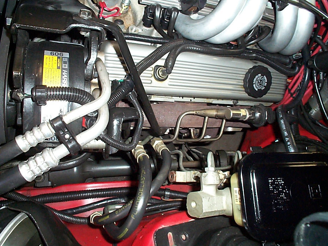

Does anyone have the exhaust mounted stabilizer bar?
Old Jul 8, 2018 | 05:48 AM
Vader's Avatar
Posts: 19,685
Likes: 318
Re: AC compressor stabilizer bar stud
This is on my '86:
