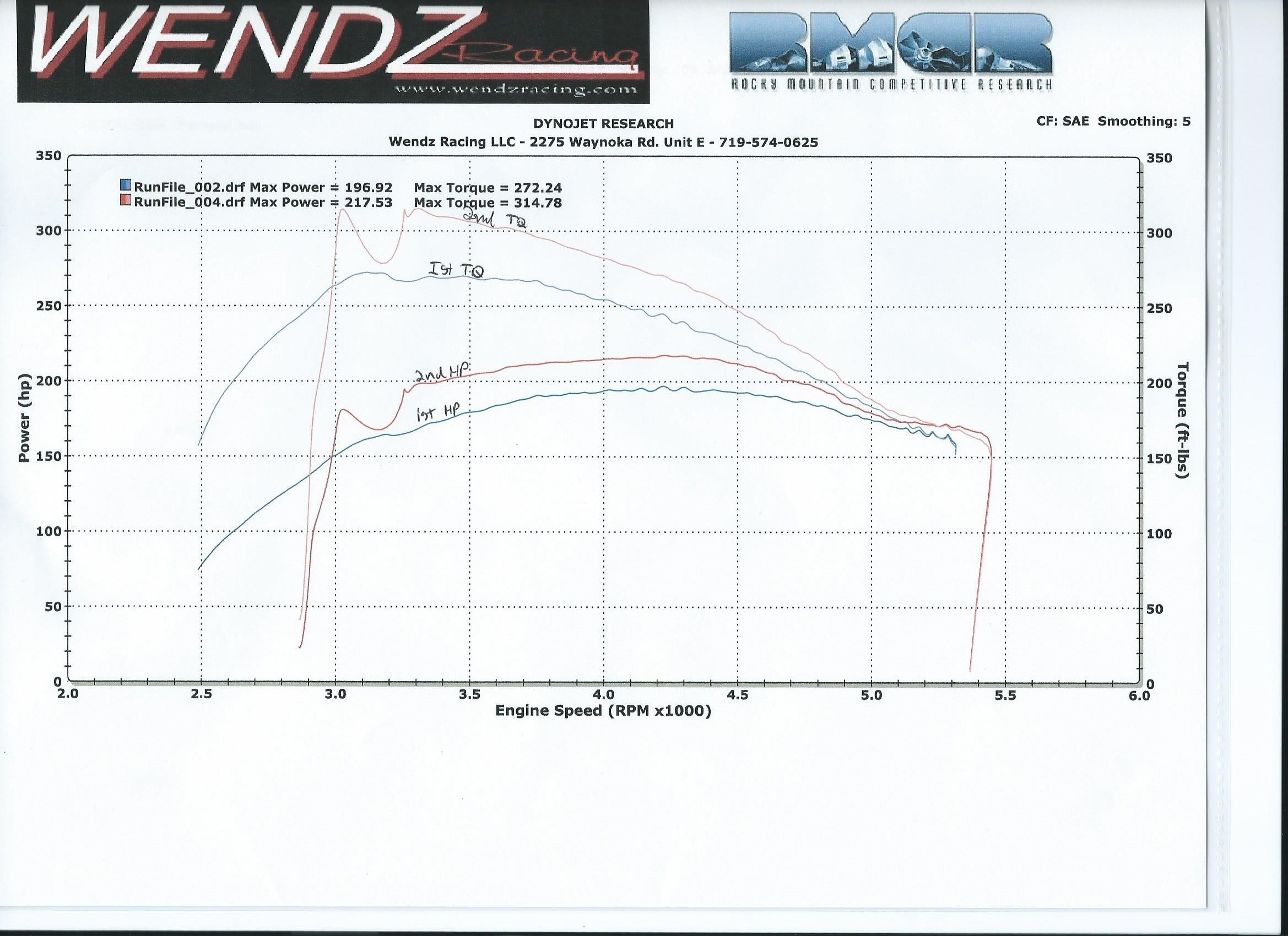

Here is a zz4 cam and heads 9.5 comp , stock tpi and stock manifolds.
I tuned it for a few hours on the street and it was driven to a Dyno a few hours away made 20hp and 40 more tq , I just sent the customer two more tunes with 1.5% and 3% more fueling to see if it can make even more.
