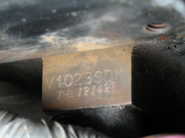

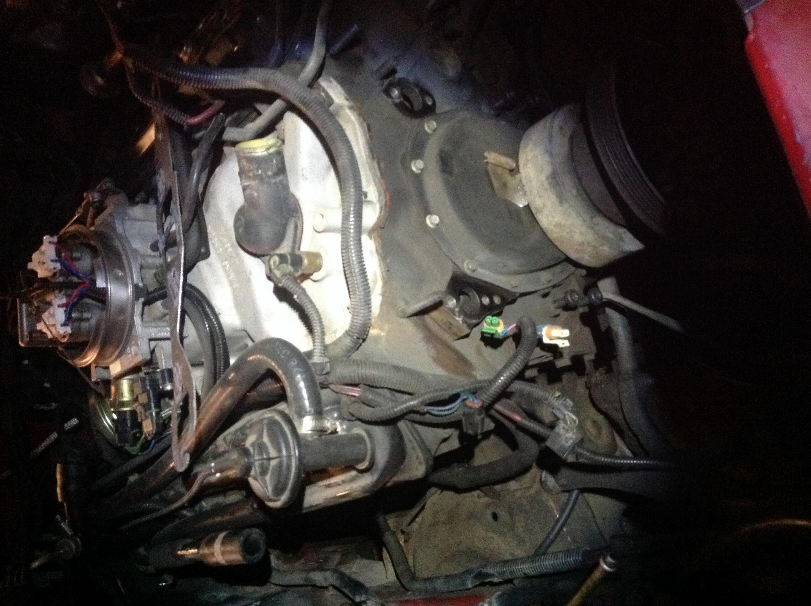

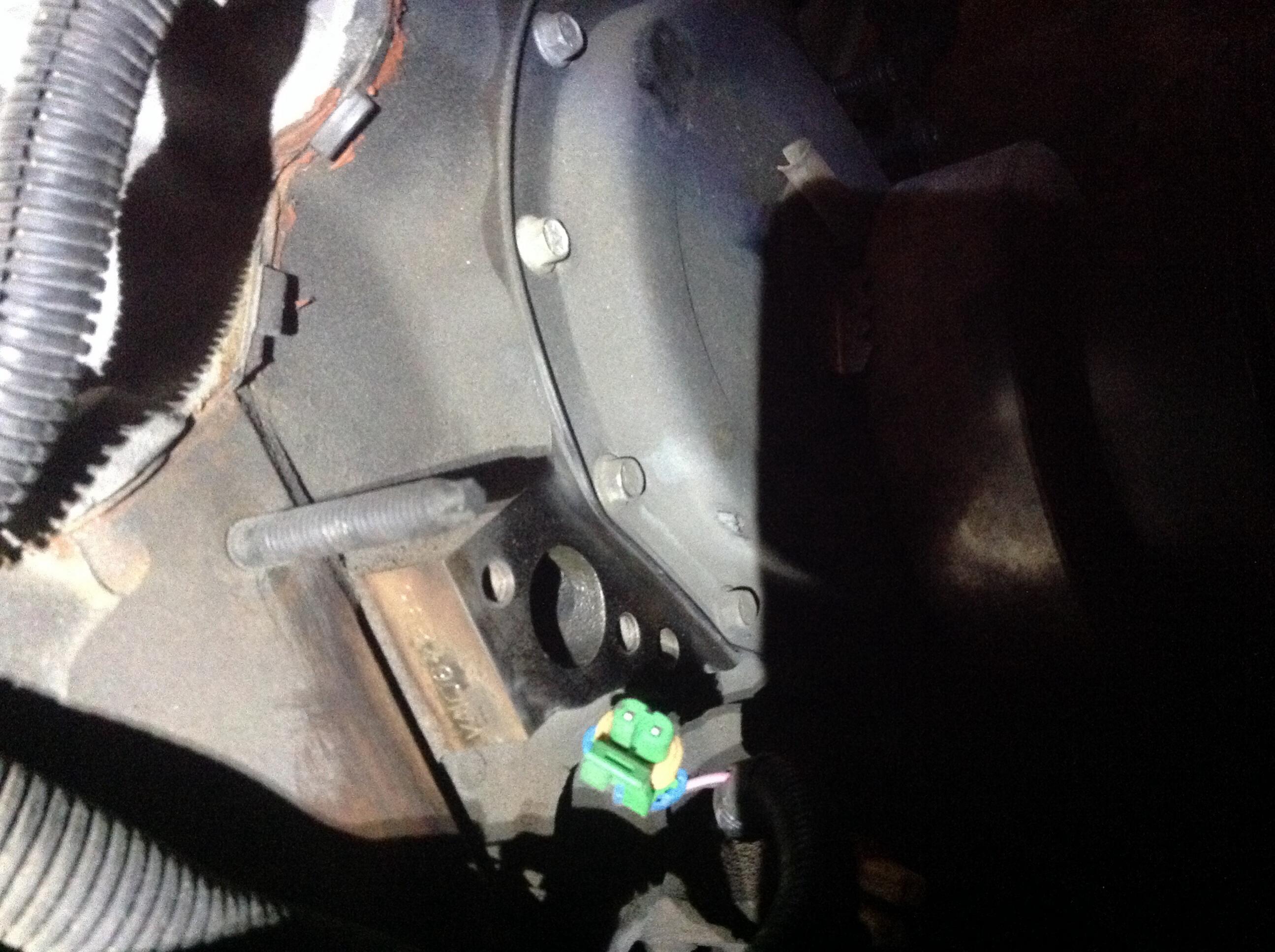

Hey I know this post is a little old but I'm having a bit of trouble identifying what I have in my bird. I'm not pulling the motor right now so I can only get to the front stamp. I can not seem to figure out what it is. Can someone please give me some advise.
Old Mar 2, 2014 | 08:52 PM
proj88formula's Avatar
Joined: Mar 2010
Posts: 18
Car: formula
Engine: 305 tbi
Axle/Gears: Ls1 3:42
Re: Engine identification???
Another pic
Old Mar 2, 2014 | 08:53 PM
Joined: Mar 2010
Posts: 18
Car: formula
Engine: 305 tbi
And a third just for overkill
Old Mar 2, 2014 | 09:15 PM
Posts: 28,015
Likes: 2,492
Looks like a small block Chevy that's been rebuilt.
The "codes" don't tell A DAMN THING about what it is now. Could have been a 75 Impala 2-bbl with 165 HP, and that's what the "codes" will say; could put out 600 HP now for all we know. Or, coulda been a "LT-1" "out of a Vette", and now it has deep-dish "rebuilder" pistons in it, a pair of 624 smogger heads on it, and a 929 cam in it, in which case, now IT'S the 165 HP wonder. Just like the guy whose post you posted in; the factory codes only tell what it was when it left the factory, they tell NOTHING WHATSOEVER about what it IS NOW.
But, the "code" you have there, isn't even from GM; it's from the rebuilder. Something like, their shop order number or some such. Totally random to any of us out here.
Absolutely no way to know without looking inside it.
