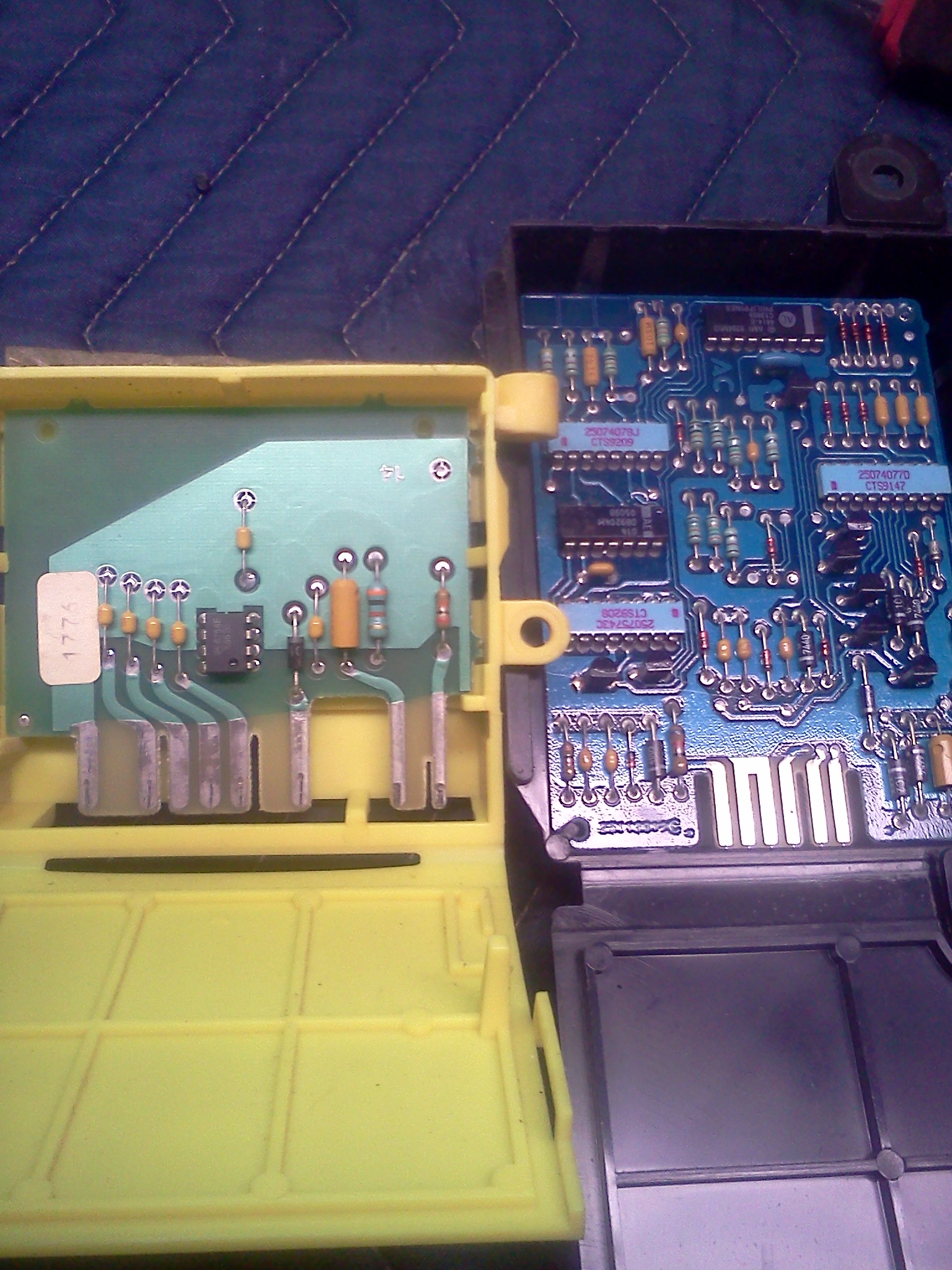

ok so the yellow box is the one I bought, the black box is the one on my car. this whole code 24 is pissing me off.
edit: I found the black box on its own bracket next to the ecm.

Old Oct 1, 2013 | 11:40 AM

That looks like the passkey module !

Quote:
being a '92 TBI the buffer box has to be there. On the right side under the dash. Look along the ledge that holds the rear-ward side of the hush panel. May need to lie on your back and look up under the dash.
RBob.
From the guy with all the answers

The buffer gets a 2k ppm magnetic pulse, the buffer converts the magnetic pulse to optical
signal 4k ppm optical to the speedometer and 2k ppm optical to the ecm.

So i have 2 trusted ppl telling me 2 different things u say 2k ppm rob says 4k ppm i currently have the 4k ppm so now when i habe another $93 ill get the 2k ppm and see if that will work then i will post results ofc this will b in like 2yrs... should of stuck with the 2k ppm like i 1st ordered in the other thread

Don't order the 2k ppm, it is optical and is designed to wire directly to the ecm and bypass the buffer. Idk what the issue is if a sgi-5 would cure it or if its the speedometer itself. But with the code 24 popping I would think its emi or loss of signal to the buffer or emi.

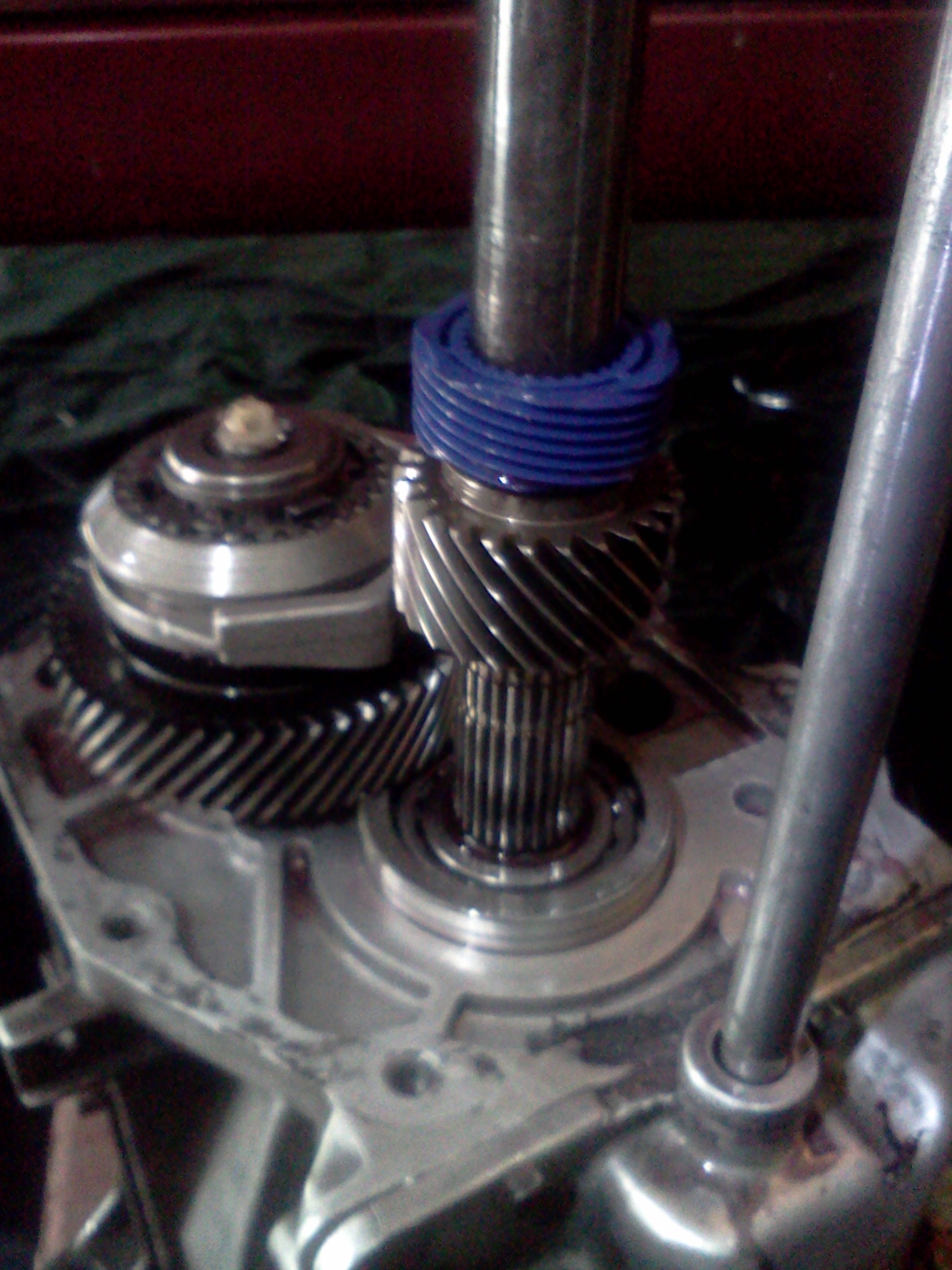

Soooooooooo heres another thing no one would of saw coming i had to take the tail cone off bc 5th gear walked... well guess what was keeping 5th gear company on the shaft? Thats right the dam speedo gear-.- so i think the problem could be fixed ill now tomorrow when i reassemble and test it.

heres the pic

Old Oct 12, 2013 | 07:33 PM

That would do it, did you find the snap ring ?
Old Oct 12, 2013 | 07:39 PM

Ya got a new snap ring but 5th snychro came apart and ofc i lost a key so waiting for some keys when ill find out
