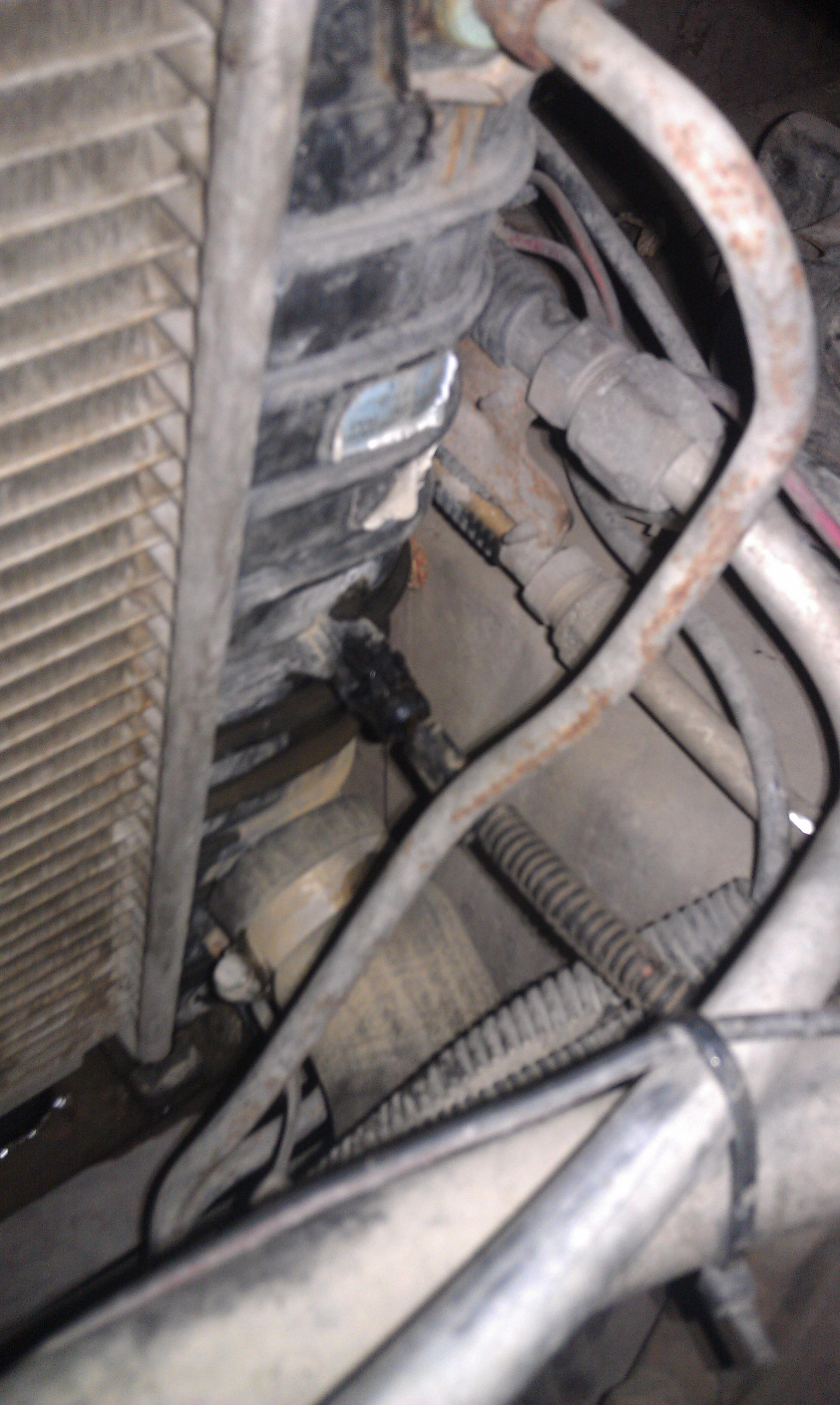

a couple days ago i noticed a swimming pool under my car. poped the hood and alot of water is leaking out of a one wire plug in my radiator, not sure what it is. i cant find it on the net. can i replace just that what i belive is a sensor or does the entire radiator need to be changed

a c4 coolant low sensor will plug the hole. gm Part 10054615

The OEM radiator bowls are plastic, is the sensor leaking or is the threaded port cracked..
if the port is cracked you need to replace the radiator..

I ordered it up. Thanks guys!
