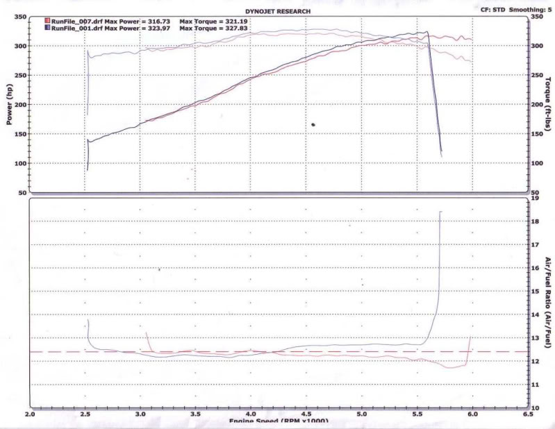

I built an aftermarket Vortec headed 355 (RHS Pro Torker) with a relatively short cam (274/282, 224/230, .574"/.569") and through a series of events (posted elsewhere on this site) I ended up with 10.4 SCR and 8.5:1 DCR. Quench at .040", flat top pistons, excellent cooling system, etc and it would not stay out of detonation. Even with the timing pulled back to a measly 30 degrees (with a slow advance curve and little initial timing) and 100 octane fuel, it would knock at the hit. Standing or rolling start didn't matter. I received tons of tuning advice on that one but eventually gave up, had the chambers worked over to gain a few cc's and went with a thicker head gasket in order to pull my SCR down to 10:1. I've run 10:1 with Vortec heads all day and never had a hint of trouble provided I followed what you described earlier regarding cooling, tune and all that.
The purpose of the data base is collect information and see who's done what with what. You want to know something? Not one person has come up with anything that runs those numbers with iron heads. That's why I'm asking for all the engine specs to be included along with a compression test. No test, no validity to the claim.
Anyway, I'm just throwing this out there. It makes for interesting conversation if nothing else.
Joined: Dec 2005
Posts: 9,942
Likes: 893
From: 53.0907° N, 113.4695° W
Re: Compression Test Data Wanted
The heads are 906 vortecs, cast iron....CC'd right at 68cc
The pistons were 12cc D-dished KBs that ended up .005" in the hole on a decked block
Head Gasket was a .038" compressed, 4.100" bore
Cam was 260/264* @ .008, , 114* LSA, 110* ICL
5.7" rods
Cranking compression is 210 PSI, Pat Kelley DCR Calculator was around 8.8:1 dynamic.

The heads are 906 vortecs, cast iron, with 2.05/1.60 valves that had been milled slightly for flatness and had the chamber sweeped for the larger intake valves. CC'd right at 68cc
I was a little off on the cam, its been a few years.
Cam was 260/264* @ .008, 208/212 @ .050, .480/.507" lift w 1.6:1 rockers, 114* LSA, 110* ICL
5.7" rods
At WOT it runs 0* to 1,000 rpm, 20* by 2,400, 28* at 3,600, back to 25* at 4,000 and slowly, but steadily climbs back to 30* @ 6,000. Coolant temps from 140*F to 170*F added 2* of timing, coolant temps over 180*F removed approximately 1* for every 10*F. There was also IAT based spark retard that started at 120*F and had 6* retard by 160*F.
On E85 this engine liked the same 30* advance up top, but wanted 8-10* more below 2,000 rpm and a smooth timing ramp up to 30* at 4,000 and hold to 6,000.
Always ran on 93 octane or E85, with a 170*F thermostat and an overkill cooling system. It was a torque monster, put down 380RWHP and 420 RWTQ through a stock stalled 700r4, heavy 2 piece steel driveshaft with carrier bearing, and GM 9.5" corporate 14-bolt rear.
Cool thing about running this setup on E85 is the SLP intake runners would stay cool to the touch year round!

Marine 6.2 is NET rated at 320 HP at the propellor shaft with restrictive marine exhaust, flame arrestor, and accessories installed. With headers, a touch of tuning, and GROSS dyno it is 370+ ALL DAY LONG.
Here is another dyno that came from my 97 Express. 206/210 cam, stock heads, marine intake, LT1 manifolds. I am guessing driveline loss is over 20% with a 4L80E and 14-bolt.

Wow! That is spectacular! You get an L31 manifold to peak at 5600 rpm! with a little cam like that! Just awesome! and even with manifolds!! How do you do it?

i dont trust any of those chassis dyno numbers. seems like all the machines are different? you can look at 2 similar builds by 2 different people, and the numbers will be WAY different.
IDK how healthy it is for a motor either? because your not simulating g-forces pushing the oil back to the pick up.

We put a 92-95 "W" cam in my brothers 97 S10, ported the lower intake, put shorties on it and it makes peak power at 5,500.

I can't read my own writing, it was 62cc, but thats only 10.41. That being said it was 380 RWHP and 210 psi cranking. Total seal rings were nearly 20 PSI cranking compression over file fit rings in this 383.
Stock 700r4 did not like it at all. Flared badly on every 1-2 shift even with a Transgo shift kit set on kill, 093 servo, and wide 2-4 band. I went through 6 different 700r4/4L60E transmissions. Most notable failure was I broke an input drum as well as sheared the case lugs of the rear of the case that hold the low-reverse clutches. That happened suddenly catching traction on the street after a burnout.
Pushed a 5,300 lbs brick to a 101 mph trap speed in the 1/4.
My 9:1 350 was 360 RWHP with the same heads and cam and trapped 99 mph, just FYI. It wasn't the quickest thing off the line with the stock 1,600 rpm converter and 3.08s, but still ran low 14s at 99-101 mph.
You don't have to have alot of cam duration or compression to make good power with a ~180cc intake port flowing 260 cfm @ .500" through 2.05" valves and 205 cfm @ .500" exhaust flow.
My 9.6:1 Hemi with similar head flow numbers put down 385 RWHP with a 212/212 @ .050, .540/.540, 114* LSA, 110* ICL cam.
My 97 Express recently put down 330 RWHP through a 4L80E, GM 9.5" corporate 14-bolt and it has stock heads, stock 9.4:1 SCR and a 206/210 @ .050 cam, marine intake manifold, and LT1 cast iron exhaust manifolds.
