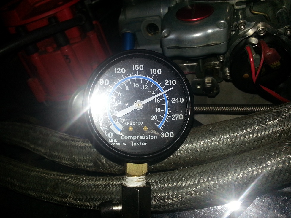

I know I’m resurrecting an old thread here but I was very excited to find it here on TGO through a google search.
I myself have a gm L31R crate engine bone stock unopened with a gmpp 14097396 camshaft (supposedly) I bought it off Facebook
DESCRIPTION
This hydraulic roller design is used on the 383 truck and Ramjet 350.
The duration at lash point in degrees (intake/exhaust) is 288/308; duration at .050" tappet lift (intake/exhaust) is 196/206 and maximum lift with 1.5:1 rocker ratio (intake/exhaust) is 431/451. Valve lash is zero/zero and lobe centerline is 109 degrees.
My compression numbers were all 208-230psi warm at 200’ above sea level pulling one plug at a time until they were all out. I had the choke warmed up and the quadrajet wide open 70 hours on the build.
I am also plagued by detonation/preignition. One major difference though, this engine lives in my boat. It’s set up with a marine intake, pertronix flamethrower 3 dizy and I’ve tried both ACDelco plugs and Denso plugs gapped to .040 I’ll have to check back on the plug specs.
Is this cranking pressure unreasonably high? I do trust the gauge even though it’s an actron from autozone.

All above 210 psi cold test at 12K miles with the 275DEH, 10.3:1, high tension rings, I didn't tested yet with the XE284H
The theoretical cranking compression with your current specs shows 204 PSI.
If that's reasonably close then the 284 should yield somewhere around 184 PSI.
To get back to the 200+ cranking pressure, the static compression ratio needs to be at least 11:1.
Best results come from knowing the actual intake valve closing point.
