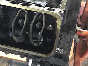

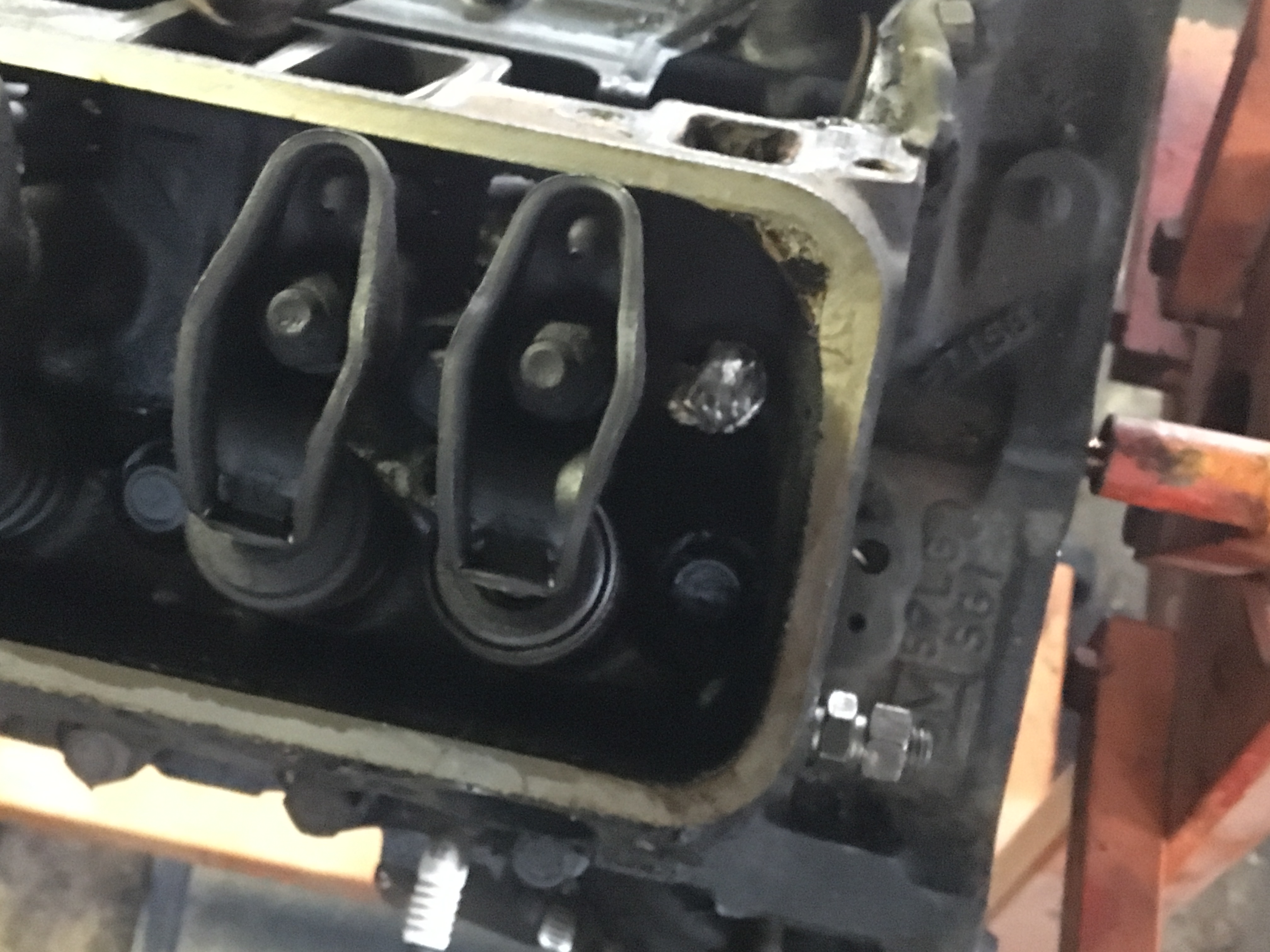

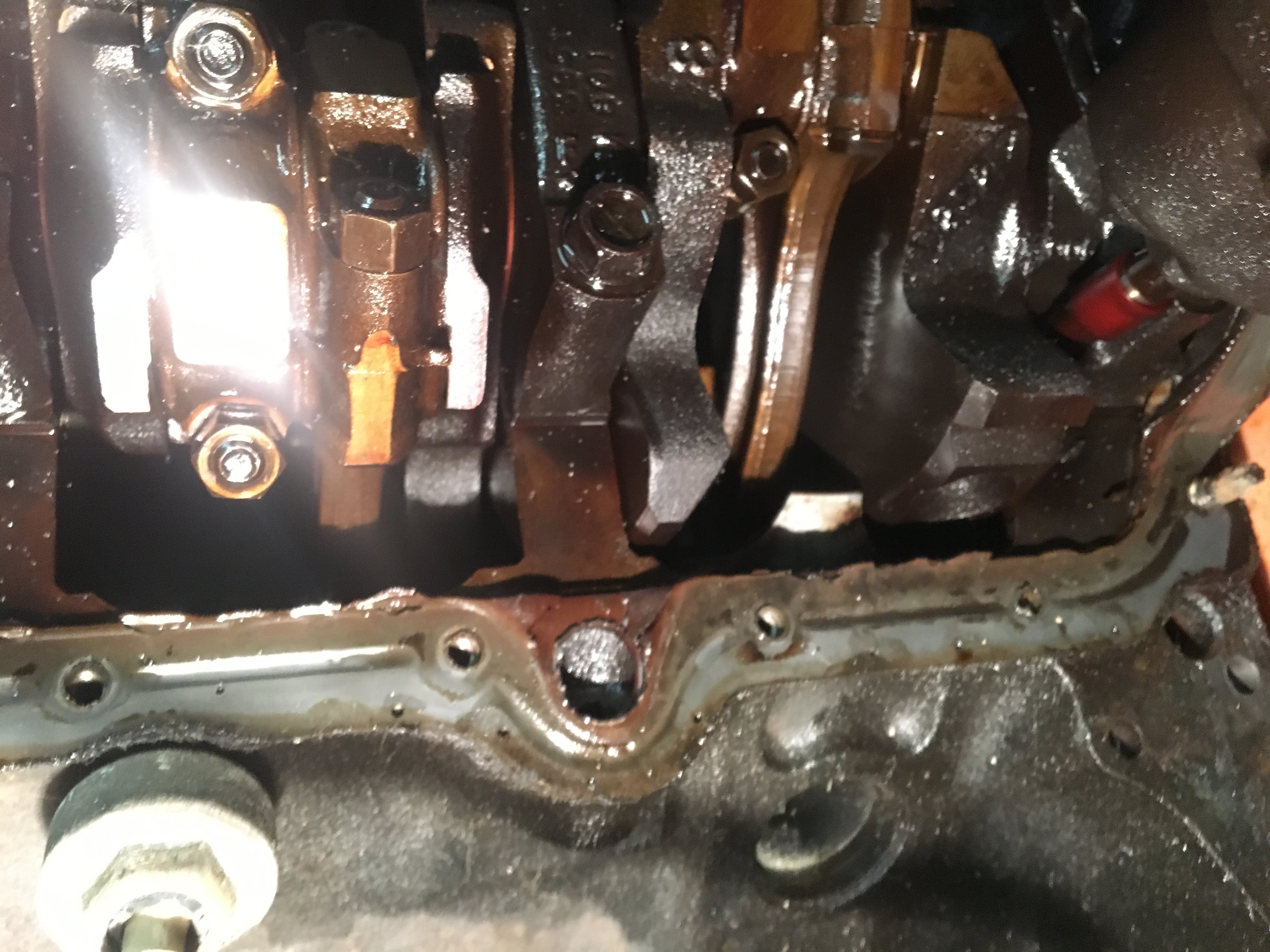

So basically better off trying to save the heads or buy a new set. And On the note of selling the other parts sure but the block is trashed. old owner dropped a tear tab into the engine and thought nothing of it. It blocked off oiling port at the back of the head causing the rod to bend slap the crank and take a 1 inch chunk out of the bottom of the cylinder
