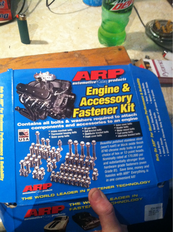

If you don't care whether their ARP bolts or not, this seems to be a good way to go IMO:
http://www.jegs.com/i/JEGS-Performan...19#moreDetails

The worst thing you can do is to use old used bolts for things like head and mains. Bolts from a 283 are at least 50 years old. No telling what kind of condition they're in. Rusted, stretched, bent, stripped etc.
As stated above, just about every other bolt on the engine is basic grade 5 NC bolts. You don't need to buy ARP to built a basic engine but there are many bolt kits available that will provide you with the proper bolts to assemble an engine.
That Jegs kit is perfect as it also supplies head and rod bolts. It does not however provide bolts for the mains. If your block has main bolts then there's no problem. If you have a block without main bolts, it will get expensive. Putting in new main bolts shouldn't be a problem but having the mains studded requires having the block line honed to make sure the main caps are still sitting true as studs and nuts provide a different clamping force on the caps.

I have the main bolts aready, (came with the block). I also went ahead and purchased head studs. So all I need is the other odd and end bolts. Tried searching JEGs but I couldn't find a set that didn't have the main or head bolts.
Thanks.
