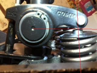

The best that I can tell my stock pushrods are the perfect length. See pics of pushrod length checker in place and also rub pattern of roller rocker.
Only thing that worries me now is lifter preload doesn't feel good. I opted to re-use the stock lifters, they looked fine but now I'm trying to set properly the plunger disk seems bottomed out, as soon as I hit zero lash and go for my half turn it immediately started pushing down the valve. Tried the next lifter on #1 cylinder and same thing.
Best solution for a budget? Clean? Toss and find some better ones? I know I went big up to this point but I had to really sweet talk the wife into another 100 bucks for pushrods as soon as I nail down height. I really really don't want to add 150 more bucks on.
What do you guys think about checked pushrod length and lifter issue?
EDIT>>> Just thought of an option....... since it looks like stock pushrod length will work, I could use the 100 dollar pushrod money for new lifters and use the stock pushrods. Bad idea? Will they handle the increased spring pressures and abuse?
As always, thanks
Attached Thumbnails 350 Vortec build thread-pushrod-length-1.jpg   350 Vortec build thread-pushrod-length-2.jpg

Couple of things:
Push rod length; I've always used the adjustable pushrod where a new length can be created and run through the checking process. However, it should be pointed that where it falls on the valve tip is secondary to the actual valve train geometry. It's the relationship between the rocker arm angle relative to the valve stem that's important.
Rather than using an a tool such as the one you have that approximates the parts you'll be using (rocker arms), the adjustable pushrod when used with your rockers will give a more precise result. If you want to explore it further, can you take a few additonal pictures like the ones attached with your pushrods and rocker arms installed?
One at zero lift.
One at mid lift.
Another at full lift.
If you orient the camera as I have in my pictures, we can see the side of the rocker and the valve stem and draw our alignment from that. What you're looking for (within reason) is a 90 degree angle relative to the pivot point of the rocker and the valve stem at mid-lift.
If I had a picture of my setup at mid-lift you would see that the 90 angle (in red) is pretty close. I'll have to fine tune that. Looking at the two pictures, I can see that at fully open the angle is much greater than when the valve is closed. This tells me that the pushrod used is too long. In the past, I've always gone for the "middle of the valve tip" method. That cost me set of valve guides.
It may be that your pushrod length is correct and this is how to verify that. If the pattern on the valve tip is centred or nearly so, then that's a bonus. Conventional thinking is that the contact has to be within about .030" of the edge of the valve and as narrow as possible (across the tip from intake side to exhaust side). This geomtry can be carried over to the pushrod side as well. Now we're talking about raising or lowering the rocker stud itslef to zero in a truly correct alignment. To me, that's really slpitting hairs and an all out race-effort, (not a short cycle drag racing engine necessarily but an endurance orientated engine).
Although a little mind-bending, you may find this article informative.
http://www.circletrack.com/techartic...y/viewall.html
Lifters; Can you actually see the plunger being depressed as you apply pre-load? (Is the intake manifold on?). I went through a set of well used retro-rollers and was able to push the plunger down by hand (using a pushrod) on some. Like you, when adjustingh pre-load, I could not achieve any resistance when rolling the pushrod between my fingers. Installing these resulted in lifter noise that could not be eliminated. That's not a good thing. If you're in the same boat, then yes, in all likelihood your lifters are toast.

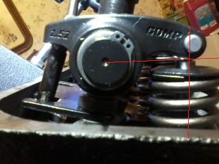

I'll do 3 posts with 2 pics each.....
These first 2 are 0 lash/ no lift
Attached Thumbnails 350 Vortec build thread-zero-lift-1.jpg   350 Vortec build thread-zero-lift-2.jpg

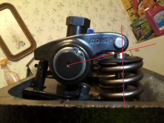

Re: 350 Vortec build thread
[quote=gbettner;5733390]I'll do 3 posts with 2 pics each.....
second 2 pics are exactly 50% lift
Attached Thumbnails 350 Vortec build thread-mid-lift-1.jpg   350 Vortec build thread-mid-lift-2.jpg

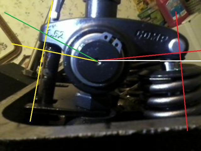

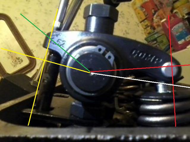

This is what I see.
At this point I'm not taking into account the contact point on the valve stem. Just the angular relationship between the lines drawn on the pictures. An equal amount of arc before and after midpoint is the target. That doesn't seem to be the case. I'm hoping others will offer up their experiences.
Question: Are you running this test on your hydraulic lifter?

Yes but the lifter plunger was bottomed out, I cycled the crank several times making sure I didn't have any varied dial indicator readings before official test was performed.
So your saying you don't think it's proper geometry? The checking tool I used is supposed to confirm perfect geometry by contacting both valve stem and pushrod. If it lacks contact to either, that measurement is what determines how much shorter or longer pushrod you need. You may already know that but wanted to make sure you know the only thing I'm going off of. Well that and the rub pattern on the valve stem.
Maybe we'll get some additional senior member "forum whales" to clear it up lol.

OK I see what you mean now, I clicked on the image and just noticed the thin red lines. That's pretty slick!
Test should be pretty accurate though, I measured max lift and cut it exactly in half for mid lift. I'll try to print them off at work tomorrow and see if I can get a protractor for readings.

If your lifter was collapsed then the results of the reading are inaccurate.
What we're seeing here is what would happen if you ran a pushrod that was shorter by the amount of the plunger travel.
You have a few options to eliminate this:
1). Use a checking spring instead of the actual valve spring. (There's one visible in the picture of my valvetrain) I picked up a handful from the local hardware store.
2). Use a solid roller lifter in place of your hydraulic. It's very important that the solid has the same dimensions (as in pushrod cup height) as your hydraulic.
3). Use an OEM roller lifter that's been disassembled and rigged with a series of flat washers that take up the slack. This more or less makes a solid lifter and the dimensions are the same as your original.
Then you can run the test again. You'll notice a difference.

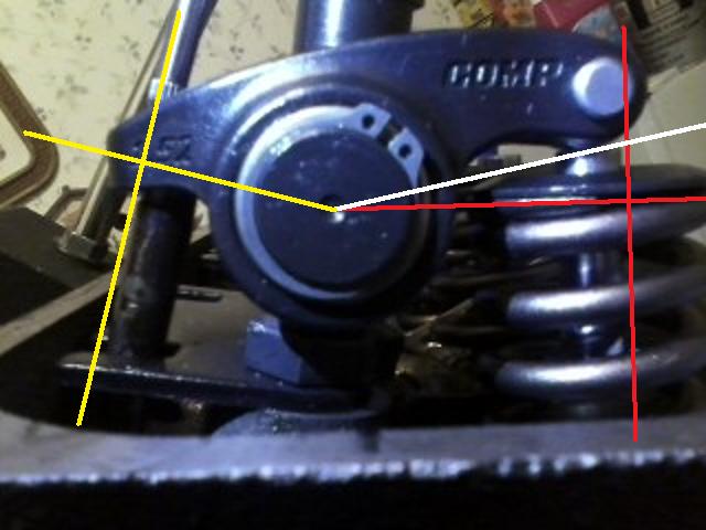

Looking at your pictures that I've marked up, it can be seen that at zero lift, the angle drawn with the red lines is small (much less than 90°) , mid lift hasn't reached 90° yet and fully open is barely past a right angle. That tells me the pushrod is too short. When you say the lifter plunger was collapsed, then the pictures reflect that.
It may be that when you run the test again, either with a proper lifter or with checking springs, you'll find that the geometry is coming in-line and will compare with the results you got with your checking tool.
Since you'll run the test again, set up the camera so that the rocker trunion is centred in the picture and we can get a good look from the side. It's helps in the analysis if all the pictures are more or less the same.
If you don't get any additional hits here, I'd like to post yours and my images in a new thread and solicit comments that way. I find that after a thread like this has gone on for a few pages, that new contributors aren't as likely.

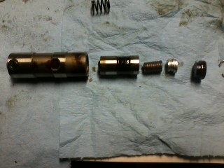

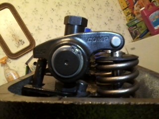

I spend forever dismantling lifter, removed spring and put in washers to the point it was about right (just a smidge of a gap under snap ring, close as I could get it).
Of the 4 new pics here are full lift and mid lift
Attached Thumbnails 350 Vortec build thread-retest-lifter-full-lift.jpg   350 Vortec build thread-retest-lifter-half-lift.jpg
Now here is zero lift and new valve tip wear pattern from roller.
Thanks again Skinny

Infernal raises a valid point about looking for mid lift. Looking at the marked up pictures, a more precise set of measurements may make a difference in whether it's a go or no go situation. Does your home-made solid lifter have the plunger right to the top?
Looks close both by the angles and the contact patch. The contact is perhaps a little wider than it should be. That's something that gets sorted out when you nail down exactly the right length but you have to consider if that's absolutely necessary. I suppose if I was getting ready for the 24 hour race at Daytona, I'd be concerned but otherwise I'd have to really think about it. I did lose a set of valve guides and until I do my own "post mortem" and set up what I had a do an analysis like on yours I won't be able to say how much makes a difference.

Originally Posted by InfernalVortex
You basically just want a 90 degree angle between the pushrod axis and the rocker arm (pushrod pocket across to the roller tip) at mid lift? That means a dial indicator at least, right?
The 90 degree angle is relative to the valve stem and the centre of the trunion. In more advanced setups I've read that the pushrod angles are also pursued.
Im not quite sure I understand how you can do this if you have hydraulic lifters. Do you need checking springs?
A couple of options are checking springs or a home made solid lifter made from a stripped down hydraulic roller packed with washers. It's important that the distance from the centre of the lifter roller to the pushrod cup is the same.
Just for assurance I took a pic of home made solid lifter plunger position ( top), the way I had washers installed inside, and a pic of the sequence of shims I used layed out on the towel.
Attached Thumbnails 350 Vortec build thread-lifter-stack-1.jpg   350 Vortec build thread-lifter-stack-2.jpg   350 Vortec build thread-lifter-stack-3.jpg
The trunion is just an axis. It has no reference orientation? Do you mean at mid lift that the top of the valve stem would line up with hte center of the trunion if you had a straight edge across the top of it? How do you even measure that?
