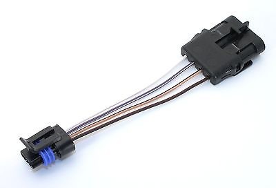

Re: 350 Vortec build thread
Its just a matter of changing the connecter, the wire colors match up to the icm in the exact same order. Or you can easly make a conversion pigtail. If you want me to crimp on the connecters send me the pigtail you snipped off the tbi harness
And buy this.
http://www.ebay.com/itm/Weather-Pack-Weathertight-4-Pin-Weatherpack-Kit-20-18-/370517905718?pt=Race_Car_Parts&hash=item5644969136&vxp=mtr
And buy this.
