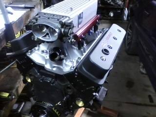

Been a little busy lately but here's the complete assembled longblock. Still have a lot of fuel line and vacuum work to do before it's done. Also want to swap in my 3.73 posi rearend before I plant the motor/trans combo in it's new home.
I'll be held up on progress for a little bit since I have to do a bunch of rust repair and welding/painting on my old van to get it ready to go to smoky mountains in 2 weeks but hopefully I'll have a chance to at least get it sat in place.
Just wanted to update anyone wandering.

I added a new set of headers, and an adjustable FPR to get my injector pressure up to 48 PSI. I Feel like a complete dumbass cause I finally uncovered a huge problem, probably the reason none of the tunes worked and I fouled plugs every 20-30 minutes before........ I had no idea Vortec heads took a much longer plug than an older TPI/TBI head. Just by dumb luck I decided to head to autozone to buy a fresh set, I brought a sample in and they weren't even close, vortec plugs are 1/2-3/4" longer than the older ones. The whole time I've been running rich and fouling plugs because of the dang sparkplugs.
Anyways, she's alive! What a beast! Snappy crisp throttle response. I haven't driven yet but it revvs like its hungry!
Just having a little trouble trying to set base timing. Brown wire by the blower motor unplugged. I think I have the timing tape put on right but it's way off the mark when it's running/starting great. As soon as I get the timing light on it and clock it towards the 6 deg mark it dies and hard cranks like the timings wayyyyy to advanced. I get it to about the zero mark and it dies every time.
Other than that just have to modify my Y pipe to fit new headers, replace plastic speedometer gears, and figure out how to datalog with datamaster ( can't figure out how to get ecm to talk to my laptop). Since this thread is so old and long I started a new thread in the DFI and ECM section.
More to come! I'm almost there!

Got er out on the road for a few hell runs. Very pleased with first run. This thing will haul! Needs some tweeking still but it's very close. Even with the 10" EDGE stall converter I can spin tires on rough country road well into 2nd gear then it hooks in hard and buries speedo quick.
Thought it caught on fire at first stop sign but it was just new headers and header wrap breaking in.
It died on me several times when coming to a stop, and after an absolute screaming wide open run ( hit 7000 rpm on accident!) it died and wouldn't start for a couple minutes. Just barely cranked like the timing was way advanced.
I got a code 44 and don't think I ever got into closed loop, I still have to figure out datamaster so I can datalog and send file to a couple guys, check my TPS voltage ( scan tool said 0.55 volts), and install A/F ratio meter.
I'll post up final results as soon as I can.

I finally got a datalog! I tried attaching file but I don't know if it worked. Final tune is in sight as soon as tuner gets back with me!

MrWillys has has really went above and beyond helping me out. I unfortunately had to switch tuners from Brian originally. Brian has been great to me and I hope his health is ok since I facebook messaged him a few days ago and never heard back. I d on't want to pester him if he's not doing well at the moment.
As far as my datalog results I'm way lean and had to upgrade from 22lb bosch 3's to 24lb, also getting a speed sensor adapter to patch into my ecm at Scott recommendation. REALLY getting close now. Already received a new tune from Scott and I have the injectors and speed sensor on the way.

Looks like I ended up at 7.400 on length. New tune and injectors just came in the mail, I'll be spending some quality time with my Iroc again this weekend!

Well I'm SOOOOOOOOO close, it's running and driving, hauls *** and hooks hard when I pour the coal to it, datalogs are good and tune would be complete other than 1 issue that won't go away........... It won't idle for crap! It dies every time I come to a stop or even let my foot off the gas. Tuner told me to try bumping up tps voltage to .60 from .55, no difference, I had to max out voltage at 1.08 to get it to idle but after a few minutes it started climbing in rpm's all the way up to 1500. If I put in gear it surges for 10 seconds or so and ends up dying. I tried tps voltage at 1.00 and it won't idle even in neutral.
Tuner has been very patient and helpful. He'll keep working with me until it's done, just giving an update.
I datalogged the 1.08 volt tps idle session and sent it to him for review. We'll see what he thinks.

I sent datalog to tuner, he thinks it's a fault other than tune. I bumped up FP from 50psi to 60 psi, got a little better but still has idle issue. I put in an old tune from Brian Shoiak and it idled and stayed running if I put in gear, somethings wrong with that memcal though cause it always has a CEL and cooling fan runs constantly if ignition on. I know that tune is set up for 22lb injectors so I took it back out since I'm running 24lb injectors.
So, what to do? I know nothing about tuning but tuner told me datalog looked perfect.
From the start heres what I've done during this whole new tune chapter.....
Bought a tune online from a reputable tuner who specializes in TPI
Figured out how to datalog and results showed lean with 22lb injectors and died during stops but would idle.
Tuner had me upgrade to 24lb injectors and install speed sensor adapter since my 89 TBI harness was converted to a 90-92 speed density TPI harness and lacked speed sensor input. Tuner also sent me a second tune.
Datalogged new tune and still showed lean. Bumped up fuel pressure from 52lb to 60 lb and still lean.
After some head scratching installed new 3 wire heated O2 and Tah dah! Started getting good O2 sensor readings finally.
Fresh datalog results were good and tuner said we're good. No more tuning needed. But it still won't idle. Tuner sent me new TPS sensor and no changes.
Any ideas guys?
