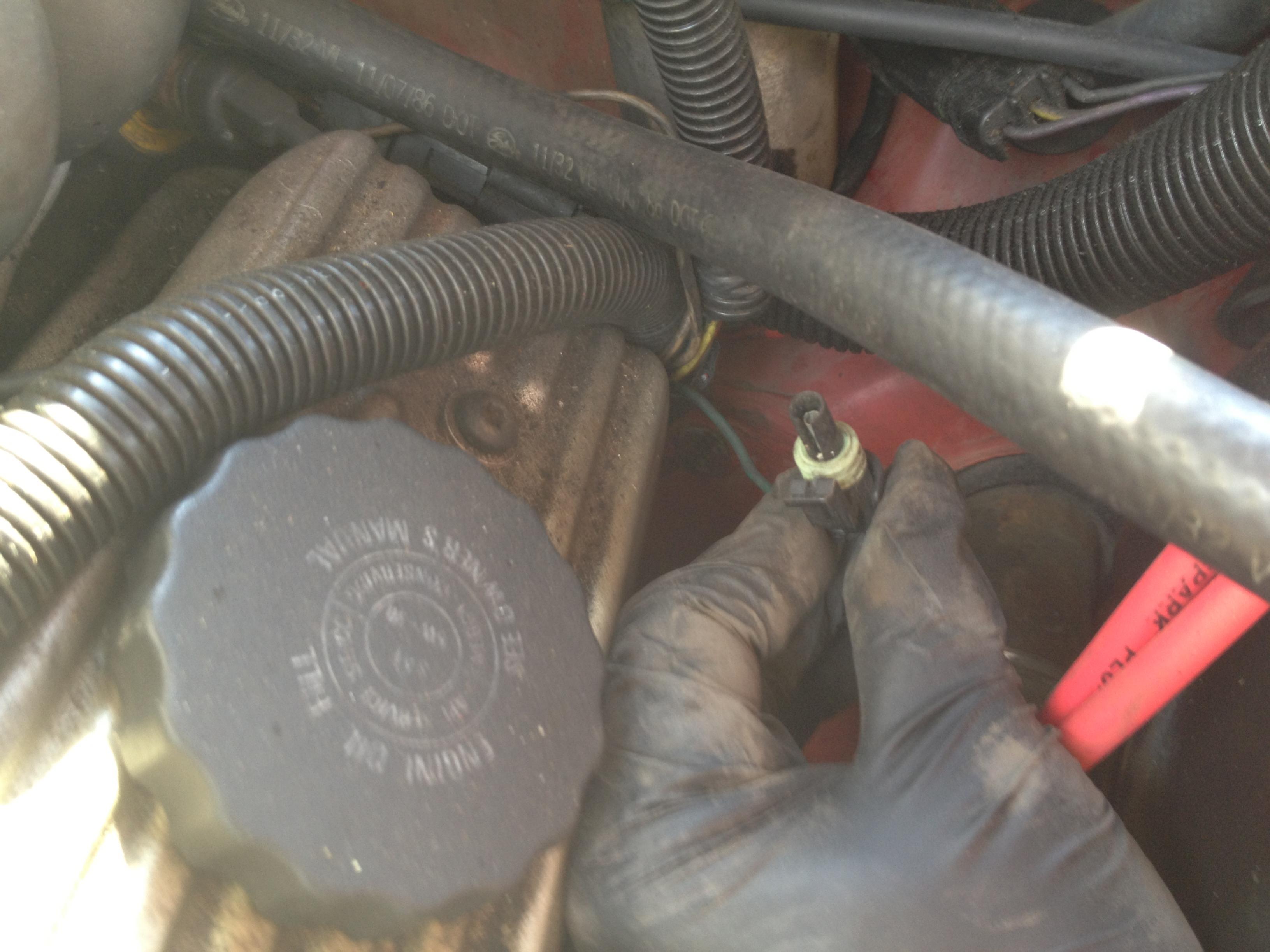

Thanks for all the help. I have been busy with work and have yet to try out some of those ideas and really trace the wiring back. I did take a quick look under there for loose wires and vacuum hoses. I found one plug, a single wire plug(see attached image), that was just hanging out. I couldn't find another mate to it and maybe this has something to do with my problems. Also, I found what looks like a vacuum hose that is buried in a harness that goes to the firewall that has been snipped off(see other image). I'm going to assume this is why my air only blows out of my defrost(or so all the threads lead me to believe). I looked for the spot that it might go to but couldn't find it. Any ideas? There is another vacuum hose coming out of the same bundle that is attached to some round device connected to the by hose to the intake near the opposite side of the throttle.
