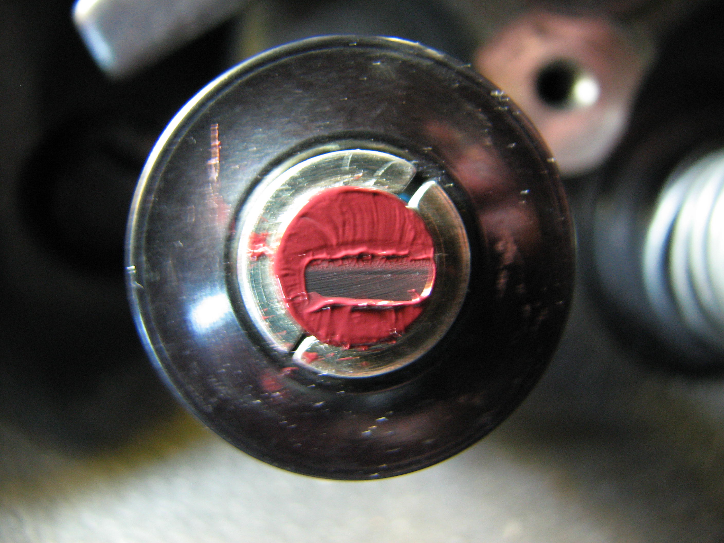

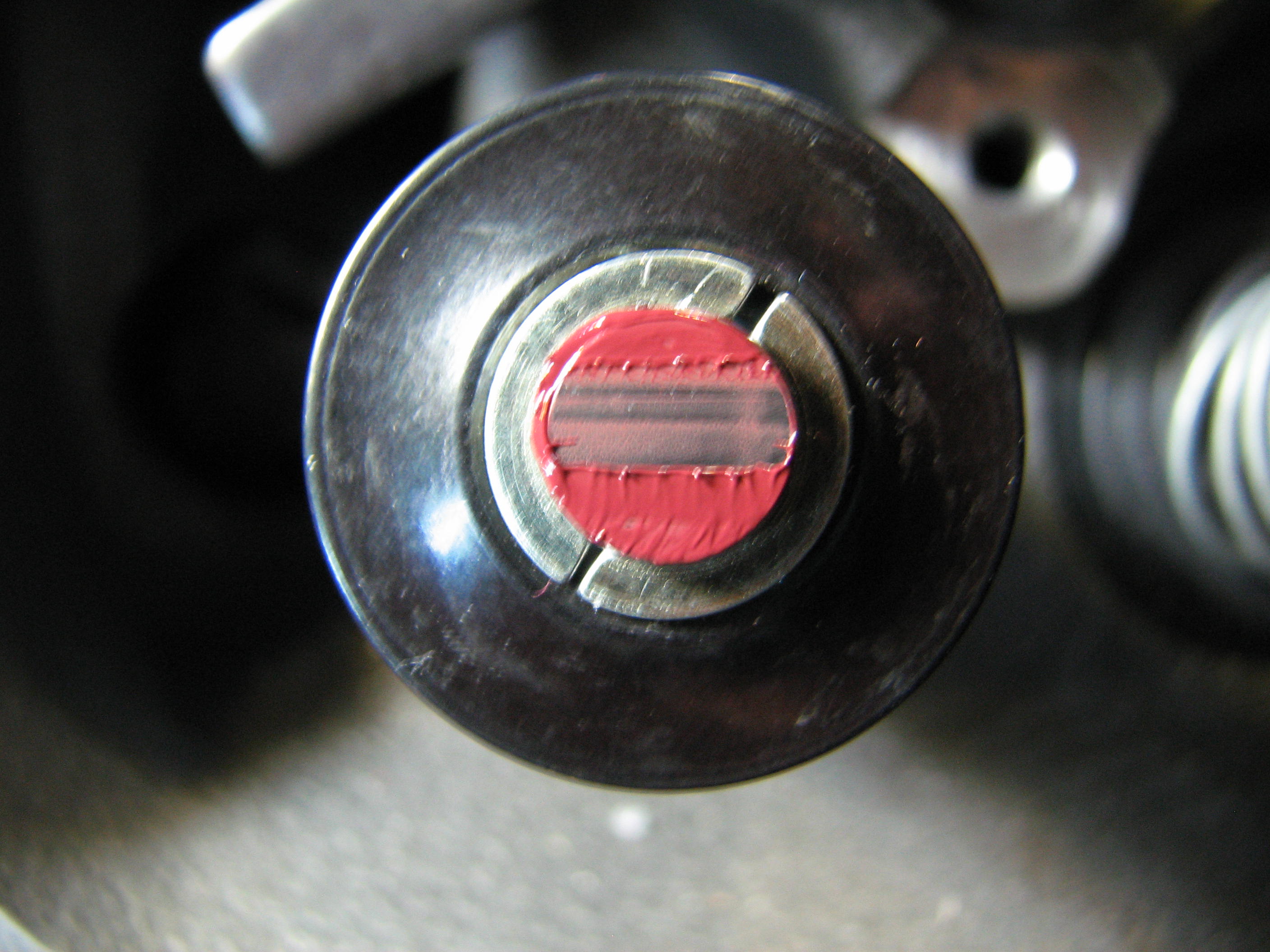

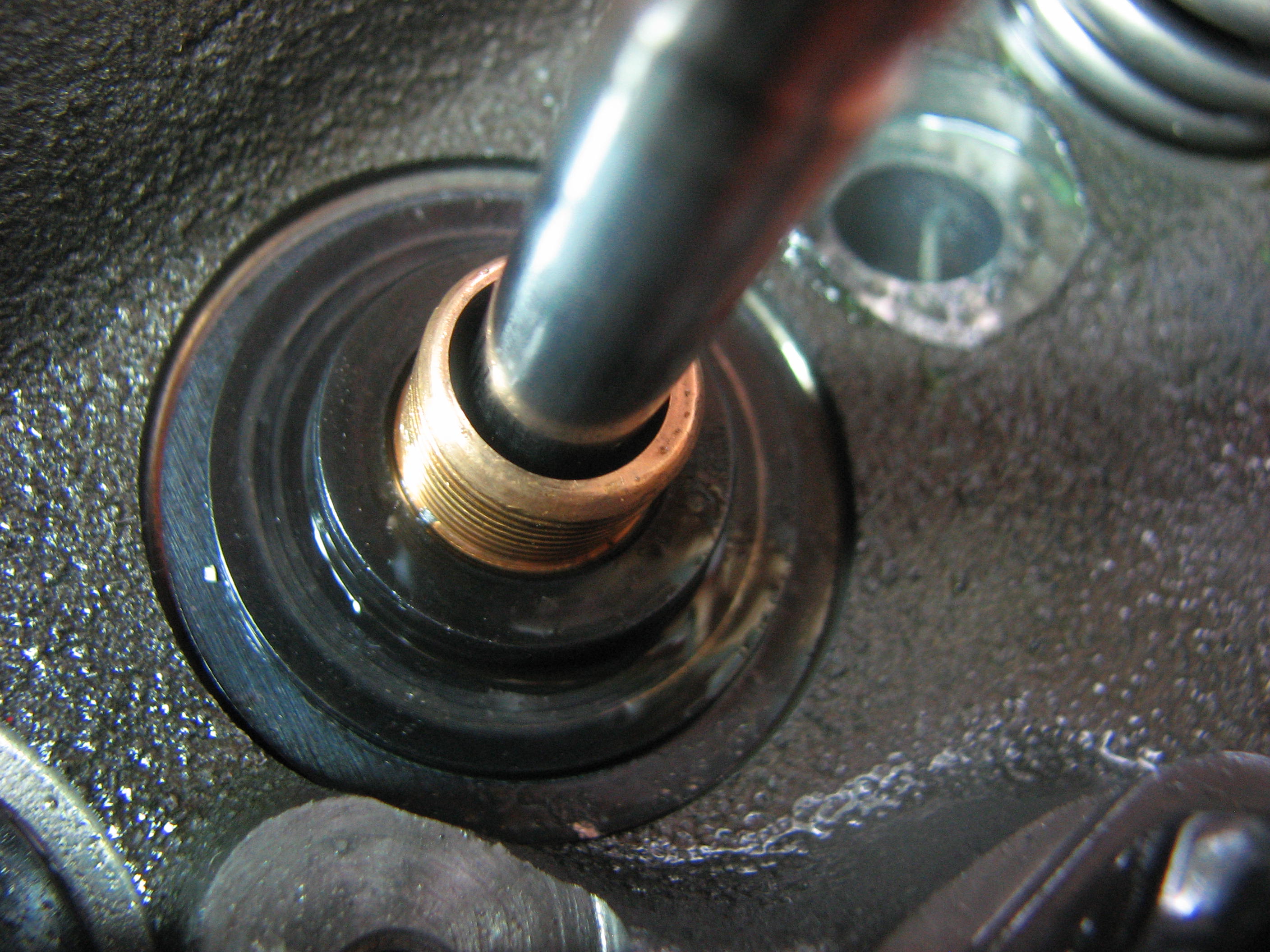

What I'll be interested in seeing is your approach in determining the proper push rod length. Some here will be familiar with the epic failure I experienced when I neglected to double check pushrod length after I swapped engine components around. I'd hate to see your valve guides wiped out after a few thousand miles.
I had planned a pictorial essay of my approach and invite comment from the "pros" however it looks like you may beat me to it.

What checker did you get? Far and away the best I've used is the Comp Hi-Tech tool.
http://www.summitracing.com/dom/part...02-1/overview/.
No measuring involved. Just extend or retract to an appropriate length and run a pattern.
That's how I produced the patterns in the above pictures. The picture of the ruined valve guide is the result if you don't have precise measurements. Very often there's a difference between the intake and the exhaust depending on the cam profile. Different cylinders may yield different results too (no I'm not suggesting that each valve gets it's own unique pushrod!). It pays to check thoroughly or you may pay the price down the road.
Pushrods are available in .050" increments so there's one that's just right for you.
I'll be interested to see how you make out and what the replies are.
