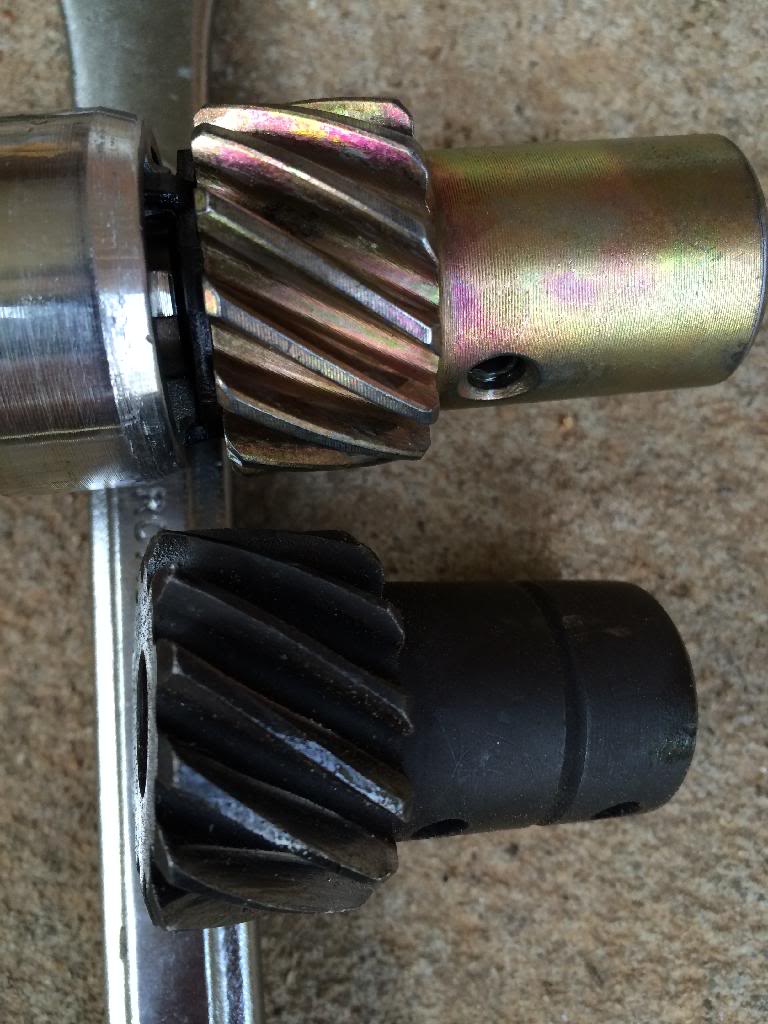

My regulator had a Tamper proof torx screw on it. I have also taken and broken the welds on ones that did not.

So here is what I've been contemplating... That was a used "melonized" gear that I took off a vortec distributor an put on my new billet distributor.
I have recently read that vortec dist diameter is an odd .491 and regular is .5". I seem to remember it not being real tight. I can't remember if I put it on as is or used a bronze one.
Anyways, I am thinking about ordering a new distributor gear that fit a my application. What material should it be? Iron, steel or bronze? I know it needs to be melonized for the roller cam setup and .5" diameter.

Just to see what I had on the distributor. I pulled it. What do yall see?
I have also included pics of the vortec gear that was in it when I orginally built the truck, it was used. About 6 months ago I dropped in a new distributor but old vortec gear wouldn't fit the shaft so I put this gear on it that I had.

Looks like I need a new dist cap/rotor. Any idea what kind of gear that is on the distributor? Bronze, steel, iron?
