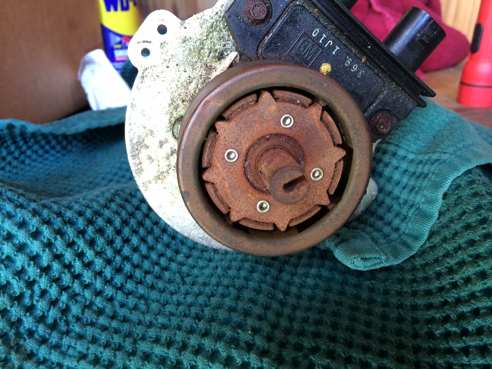

Also...I pulled my distributor...looks pretty rusted and worn out. Does it matter or does it need to be replaced...and could that be causing my erratic idling?
Adjust your TPS to be around 0.56 volt. I dont think it will help your problem. But you migth as well fix it..
Its hard to say if your distributor is the problem.
But that rust can perhaps mess up the signal to the pickup coil.
If you have ability to "scan" the car while it idle. I would be interested so teh IAC steps..
