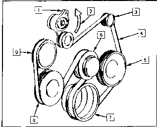

The length is slightly different based on which routing you use. Based on the pictures, I believe the 89 routing uses a longer belt.
Example; If the belt is too long for the 88 routing, try the 89. Likewise, if too short for 89, the 88 route might work.
