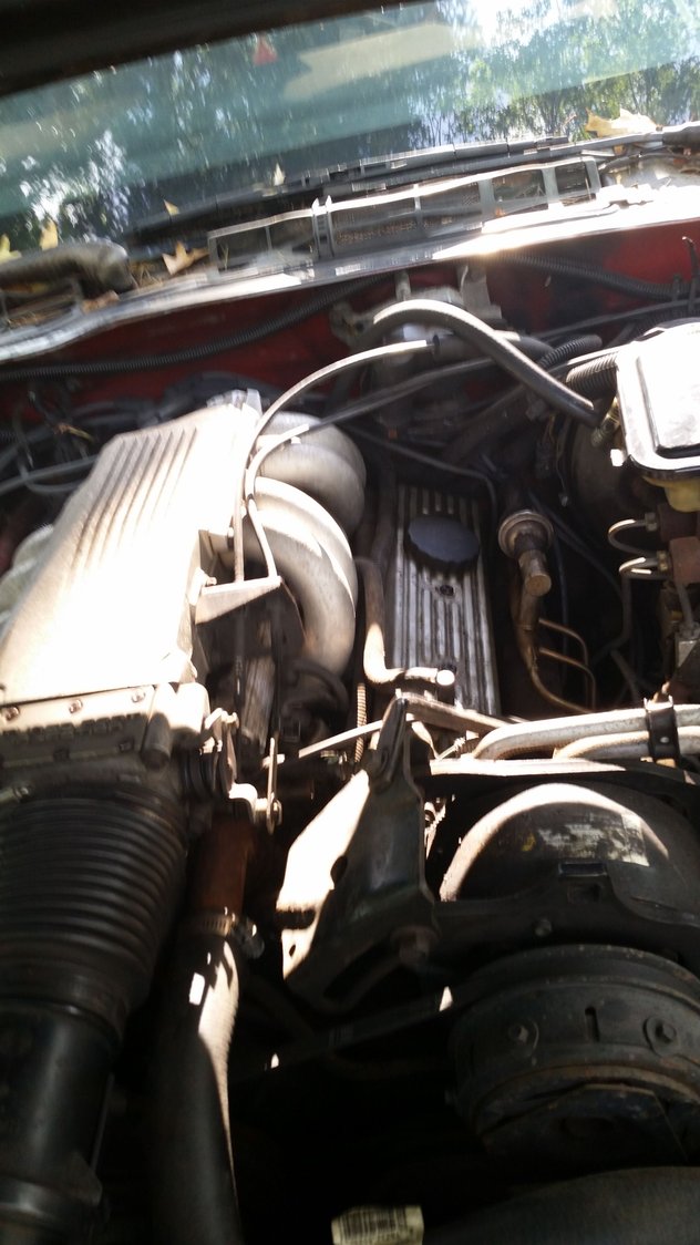

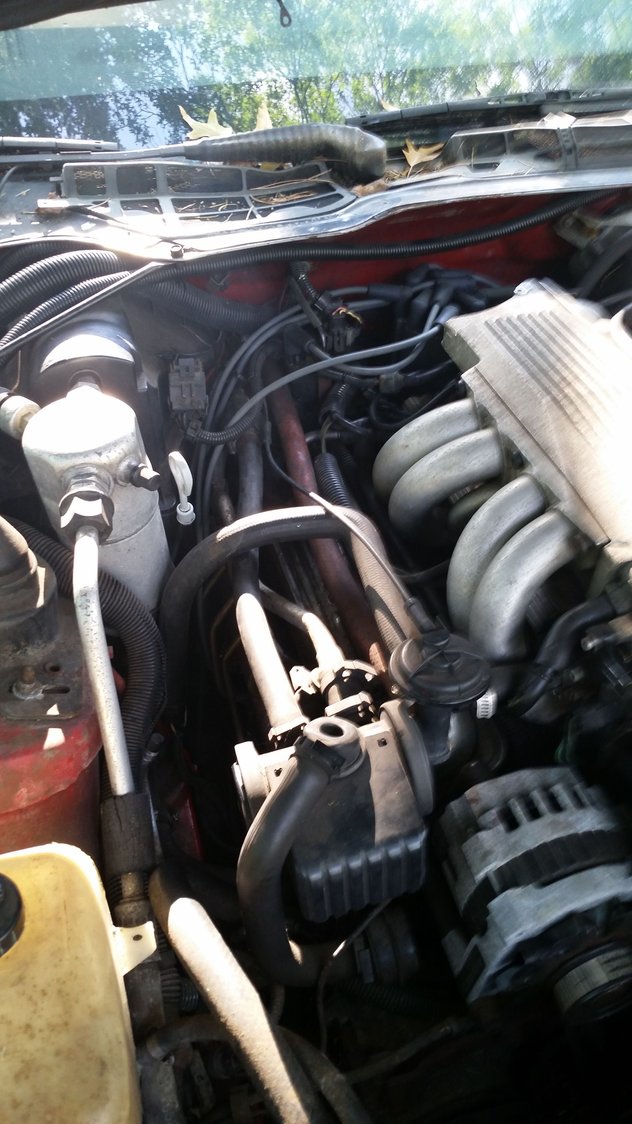

Update: smoke is coming from both sides now and when ever i rev the engine the rpms will go down at a snails pace or not go down at all. i checked the throttle and that closes fine. oil on dipstick seems low but the gauge says its full. this is the video of the smoke
passenger side
driver side
