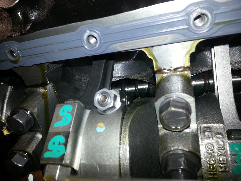

Ok so from left to right. New motor with stock tray, wrong transmission bolt in one hole, car before motor was pulled, picture of the stock vortec rods, old motor.

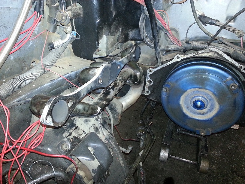

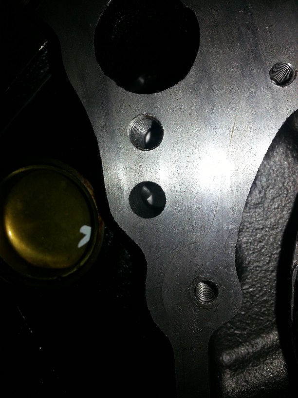

After motor was pulled, old damper that was separating, hole for passenger side of block ( It turns and is suction side of pump. The hole goes to left in picture and other side of hole is next to passenger side freeze plug next to it )
