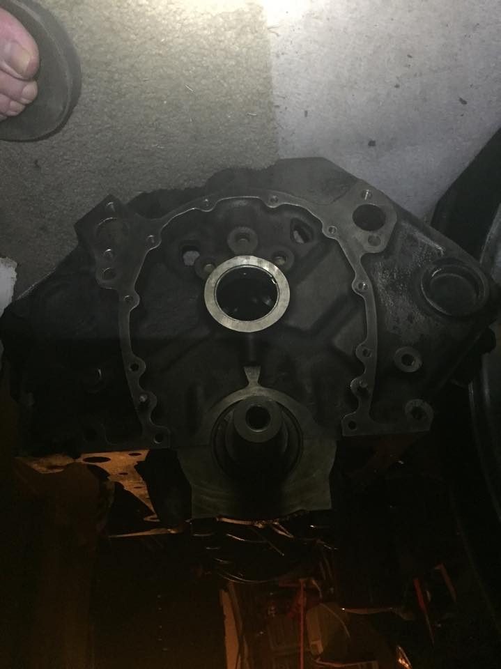

Hey guys.
I am wanting to build a motor. I have a stock goodwrench 350 short block. Casting number 10066036. I have found some 882 heads that I am thinking of buying. Now I am wanting to get close to 400hp. Ive been told I'm crazy but I want to try. Anywhere from 300-400. I dont want to spend a lot of money on new parts so I will be looking for used parts and trying to get whatever parts I need for that high amount for cheap as i can get them. Im going to be putting it in my 91 z28. Not worried about the rear end yet just want to get the engine done first. Any help is greatly appreciated. I have an uncle with a full machine shop who can help with the machine work. Also I dont want to take the bottom end apart and keep the TPI system. Please recommendations, help, knowledge, guidance, or whatever you guys can give me is greatly appreciated.
Thanks in advance
Thanks in advance

I really didnt want to take apart the bottom end cuz its all put together. Would heads off the 305 tpi motor work or is that even more work? I was thinking of using the cam out of the 305 since it is the same cam for the 350 but I can get a new one. it does have the holes for the cam plate to bolt down and hold. So how would I keep it in?

With a flat tappet cam, the lifters holds the cam in place. The lobes have a slight angle to them and when lifters sits on lobes and valves are adjusted the cam don't/can't walk.
Roller cams needs a retainer plate/thrust button to keep cam in place cause the roller wheels on lifters are smooth and cam lobes are cut straight.
Your 305 TPI is a roller cam engine and your 350 is a flat tappet (non roller) engine.
You can not use a factory roller cam in a non roller block

So guys if you have links to any parts you suggest that would be great so I can see what I'm looking at and kind of get an idea of what I'm putting together and an idea of prices
Also I don't have a timing chain and a distributor so I need one for all this. It's a bare block except for cranks and Pistons. Nothing else on it
Found a pair of 062/906 vortec heads. Need a edelbrock intake for a carb, what is a good one that allows breathing? Any links to a vortec intake you guys suggest?
Also I have ABSOLUTELY NO IDEA how to choose a carb that matches the cam to maximize performance out of the two.
Am I trying to get a 62/63 or higher? Can I change that to help or change valves to bigger ones to allow more breathing perhaps?
What Cam do i get. idk where to look for it and not sure what kind seeing how its not a roller motor. Maybe some valve springs to help or change with the cam/lifter combo. Any links for recommended cams or cam/lifter combos? Any links will help so I can ball park.

Ok... Your looking for a budget minded build so I will post links to my recommended
budget based parts that would work good for you.
Vortec heads... Stock valves, don't go trying to install larger valves or what not. The vortec head as is, is the highest flow, best production (stock factory) gen 1 sbc head ever
Any of these intakes would work great
http://www.competitionproducts.com/P.../#.VNry6ubF_bM
http://www.competitionproducts.com/P.../#.VNry8ubF_bM
http://www.summitracing.com/parts/sum-226018/overview/
http://www.summitracing.com/parts/wnd-8121/overview/
http://www.summitracing.com/parts/pfs-52028/overview/
If it was me, I would go with that last one, crosswinds for $176
Cam... Here is what I recommend.. http://www.competitionproducts.com/E.../#.VNr08ebF_bM $147 cam, lifters, springs, valve locks, valve seals.
This is a 214/224@.050" cam which is a nice mild performance size. It will give a slight lope only enough to tell it's not stock. Makes a lot of low and mid range power and will pull good to about 5300 rpm.
I have used that very cam in quite a few 350 engines.
Run a 600 cfm carb. Holley or edelbrock, your pick. I really like Edelbrock carbs for street engines. I have an edelbrock 600 on my vortec headed 355 in my S10, and have a Holley 750 on my Brodix headed 355 in my camaro.
Use Fel pro MS 98000 T intake gaskets, Fel pro 1094 head gaskets
With a set of 1-5/8" tube headers and good aftermarket Y pipe and exhaust this will be a mean street engine. In the 350-375 HP range easy.

Wow exactly the kind of answer I was looking for. Although I've never heard of competition products.
Also does a distributor and a water pump play a big part because I need those too along with a timing chain. The block is completely bare except for the crank and Pistons

Hey man, so I don't know if it's been covered but I haven't seen anyone mention that stock production Vortec heads won't support anything past .450 lift. Like MAX .450 and I wouldn't personally even push that. It's been a while since I've researched it but in order to get decent lift out of the heads there is a decent amount of machine work that has to be done.
Now something you can do for the spring issue, is install LS series Beehive springs, sounds crazy (GEN II vs GEN III engine) but it works. Hot rod did an article on it and I've personally done it myself. Increases lift to about .550 and requires zero machining. You're going to need different retainers, 7 degree I know that much, can't remember the valve stem size.
In fact, I'll send you a PM and I can answer any questions you might have.

With the cam I posted for him to use the lift is .443"/.465" and comes with good springs, IIRC they are 110 # springs
That cam will work with vortecs and no machining needed, at most he will need to use +.050" locks which are $15 at competition products

Ya I tried to install the LS6 springs in my vortec 906 heads before I had them machined for the comp cams beehive springs and they did not fit. The valve guide boss measured .9" the inside of my beehive comp springs were .84" My machine work was machining the valve guide boss, re surface my heads, lower the valve seals but re use the stock seals cuz I feel there better than normal stock chevy seals and install screw in studs. My heads have .580" clearance between the retainer and seal and before coil bind. The cost was $580 total. That was machine work not parts
If you could find some stock aluminum L98 heads you might be better off. They might not make as much power but they will not need any of the machine work I had to do to my heads and are easily capable of 350 HP. On a set of aluminum L98 heads I would run a single pattern cam like a comp magnum 270 and a duel plane intake.
If you could find some stock aluminum L98 heads you might be better off. They might not make as much power but they will not need any of the machine work I had to do to my heads and are easily capable of 350 HP. On a set of aluminum L98 heads I would run a single pattern cam like a comp magnum 270 and a duel plane intake. Re: Building an engine. I need help, I am a novice builder
What locks are you guys talking about?
Changing springs and retainers can help with breathing and help with lift? Which translates to room for a big cam? Just a question to try and understand more.

The stock lift on vortec heads are only good to around .450 which isn't much when looking for a decent cam. In order to install basic after market springs there is machining required on the heads. The LS1 Beehive springs are a direct install that don't require machining and make your heads capable of .550 lift.
That's basically what we are talking about.

I have built MANY vortec head engines and the lift clearance is only a slight prob.
On lower lifts under .485" all you need is good springs like howards 1.25"/1.26" OD 90-120# springs, remove the flat damper spring, and use +.050" locks if needed.
Higher lifts you need the above plus grind 3/32" off bottom of retainers, or buy diff. retainers or beehive spring set, etc
Key here is YOU must measure your guide and seal to retainer clearance and set the heads up right.
On my S10, I'm running a .484"/.512" lift cam with vortec heads. I'm using 115# springs and did the "ghetto grind" on the stock retainers and having no probs.

What is 0.450 + 0.050? That's .500" So by adding +.050 locks you add .050" extra clearance between the guides/seals and retainer.

Oh, ok yeah if you didn't see the part about the locks then I can understand the confusion.
Here's the locks I run on most vortec head builds http://www.competitionproducts.com/V.../#.VOOIf-bF_bM
Pushrod length should ALWAYS be measured as so many things can change it, but no the vortec heads in their selfs will not change the length pushrods you need vs. any other stock iron GM head
With a hyd flat tappet cam 7.800" is the stock size.
